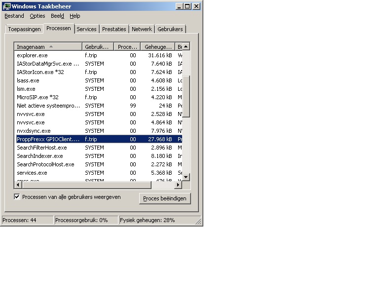

Re: GPIO Client
Bernd
Unfortunately, when i close the GPIO client with right klick close, under processes the gpio client is still running as a service.

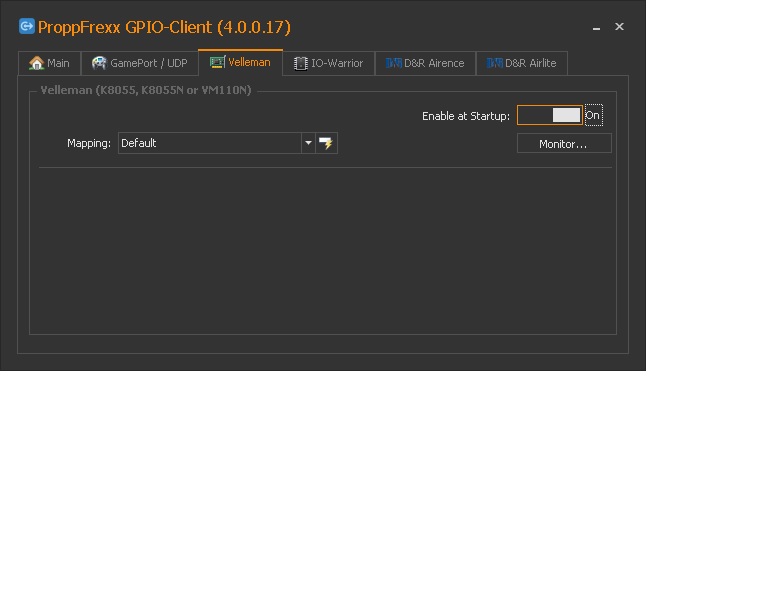

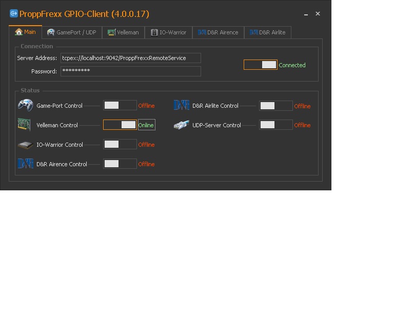

Re: GPIO Client
Bernd
The license of version 3 is not a problem. Did a quick test and everything seems to work, also my Novation launchpad.
I did a completely uninstallation of version 3 and 4. Then installed version 4 back again, and enabled the GPIO Ext. Service.
Then clicked ok, and after that the client starts, is visable and i can open it.
I changed the password into the one i put in at the TCP RemoteControl server port. Directly it connects. Then into the client i enabled it on startup and close the gui. So far so good. The start buttons are working correctly.
The i close proppfrexx. The client remains running (see one of the screenshots. Watching the task manager i see the gpio client is still running. See screenshot.
Hopefully this makes it a little clear to you.
Friso
Friso

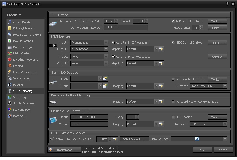

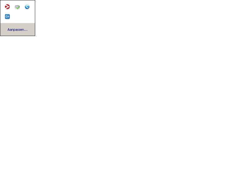

Re: GPIO Client
And another two screenshots
- screenshot_5.jpg (94.4 KiB) Viewed 13081 times
- screenshot_4.jpg (11.82 KiB) Viewed 13081 times
