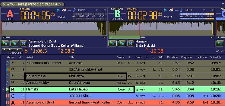

This is my filter on the script line " ~[Genre] <> 'House' And [Genre] <> 'Slow Jam' "
and it takes house from the Library
'UseLastTrackOnFinalFail' script option is not setted
as you can see in the screen shot that it ignores that filter and plays House And Slow Jam!

I just made a few tests here and can not reproduce that - it would even make me wonder, if that really fails.
Are you sure, that those entries are from exactly that script line having that exact Filters set?
(e.g. you might display the 'Source Info' column in the playlist to confirm that)
May be there is a 'hidden' extra char in your original file's 'Genre'...
e.g. some thing like "House " or " Slow Jam" or "Slow Jam" (having 2 spaces between Slow and Jam)?
Else we might do a TeamViewer session today - to take a look to your config.
Please send me your TeamViewer details in a PM or mail.
