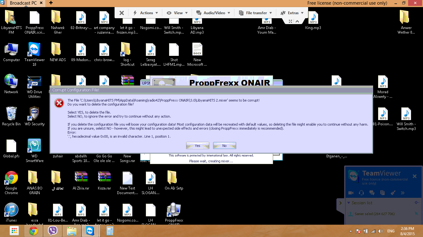

i have this problem happens when a sudden power failure occurs and my pc shuts down suddenly, the problem is when i restart the PC and open PFOA i got an error message idicating that many files have corruption as (Schedualer, Song History, Configuration, my mixer setup, overlay schedualer, etc...)
every time that happens i had to copy a backup version of 3.0 folder and delete the corrupted one.

- screen shot for the error
- Screenshot (26).png (149.13 KiB) Viewed 6479 times

The mentioned files are already only written to disk whenever a change is made.
E.g. the mixer setup is ONLY saved when you change the mixer setup OR the scheduler file is written when you change the scheduler entries etc. ... all these files are as such NOT saved (written to disk) very often.
The only files, which are changed a bit more often are the entry statistics and the song history.
So your proposed solution wouldn't really help.
Also note, that any OS (Windows) and or your hard disk controller/driver actually caches the data written to disk to optimize performance. So there is no 100% guarantee anyhow when and what data is written at what time.
Of course there might be certain strategies be implemented for High-Availability systems - but believe me, the cost is much higher then a simple battery solution as proposed above!
Also note, that in case of a power failure your entire system might be corrupted incl. a possible hard disk crash (so it is not only ProppFrexx being affected)! In your case you might (luckily) just discovered an issue with ProppFrexx - probably because you used ProppFrexx during the power failure.
In essence I really see no benefit to implement a solution you proposed, as it would only bring the 'chance' or 'probability' down by a few percent! Believe me, it will not bring it down by 50%!
As such, if you are really affected by often power failures, I really recommend a battery backup solution!
