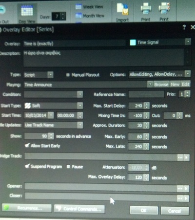

I 'll describe what happpens:
There is a program A playing for 20:00 - 21:00. A new program B is about to start at 21:00
The last song of A ends at 20:58:30. My time overlay (21:00) is scheduled to start early 90secs.
The overlay shows delay about 4mins !
Program stops, NOTHING IS PLAYING !, the overlay is waiting and when the countdown ends, it starts, plays the time announce and then starts the new program.
This has happened two times.
I send you the debug log to check it out.
Please help. I am losing my listeners !

I forgot that I did a change to the overlay.
The change was that I added Max. Early=60secs and Max Late 240secs.
All the other settings were the same as past :
I noticed that the delay of overlay is that much as needed for overlay to start at XX:04' (eg 21:04, 07:04)
Today I also noticed that the 1st track of the next program (07:00) played at 06:55.36. I have in settings "Script/Scheduler" program start time 90secs.

The values I 've changed was Max Early and Max Late (both were 0).

ok. Let's stay on the silence issue.
I am still using .18
What I did now is set Max Early and Max Late to 0 and see if silence happens again.
I 'll let you know.
