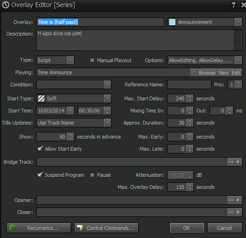

When there is a parallel overlay, the other one plays normally. Only the Time Announce overlay does not play.
Look at the settings for the time announce overlays:
The last week I have not changed anything except updating to 15.16 version.

I had created 2 overlays with 1 hour recurrency. Time "Announce Exactly" and "Time Announce Half Past"
Those are the only overlays that do not play.
And YES that is exactly this one.
I am listening to my radio and that overlays do not play. That's why I tried to find what is wrong in log files.
And YES I recreated the overlay and it did not play.
