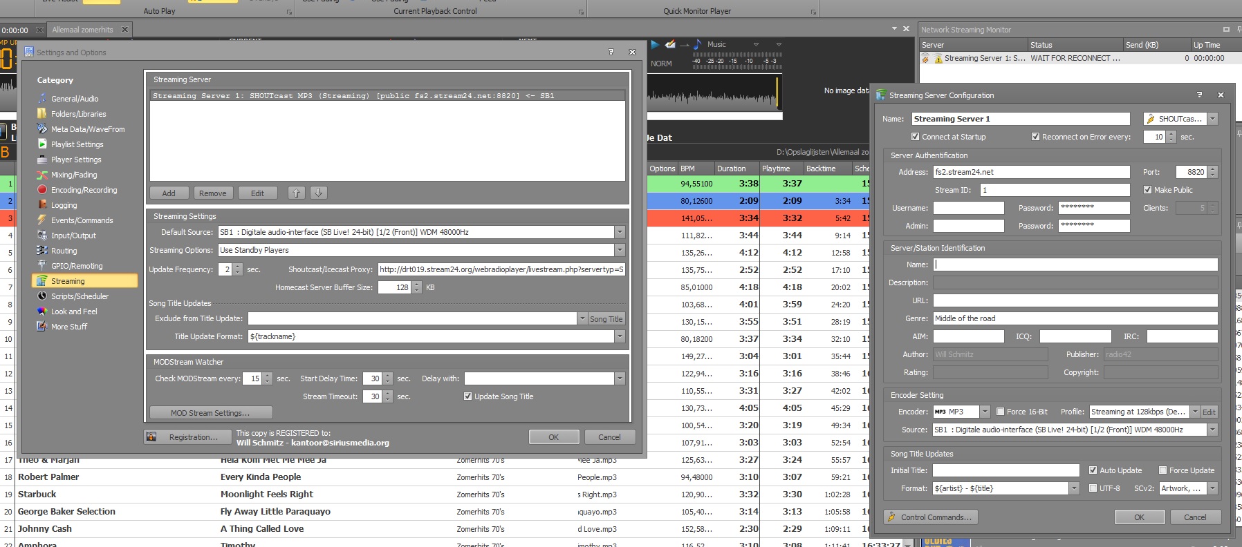

Hi.
Strange problem.
I'm able to connect to the server over shoutcast and play music over winamp. Works like a charme.
PF on the other hand doesn't connect at all.
The adress : fs2.stream24.net, checked password several timesis oke.
Port 8820
It just doens't work.
Who do i do?

- Fstream001.jpg (386.03 KiB) Viewed 9275 times
Re: Wait for reconnect
This is because you are running a SHOUTcast v1 server - but have (within ProppFrexx) given a 'Stream ID', which then lets PF use the SHOUTcast v2 protocol.
As such, simply leave the field 'Stream ID' empty! and try again
For more info, just click on the 'question mark icon' at the top right of the Streaming Server Configuration dialog.

Have you tried what I have written above?
Just remove the value in the field "Stream ID" in your streaming server configuration!
The values for AIM, ICQ and IRC are optional, leave them also empty if you don't know what to put there
If you are still stuck PM or mail me your TeamViewer details (if you have that installed) to do a remote session.

Hi Bernd, i need to apologise for acting this late.
Yes, it does work which made me very happy. Honestly, i asked Per to assist me. He got the problem solved within a few minutes. PF was not able to connect because of the audio. All audio from the soundcard was 48khz, while soundcast accepts only 44.1 kHz. I felt embarrest no noticing that. So problem solved. Another solution in al long learning process. Thxs for youre quick reacting.
Will
