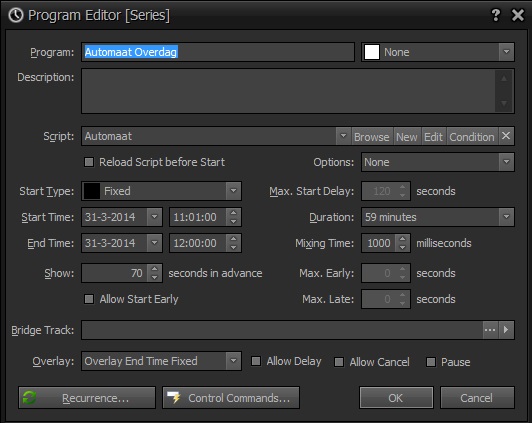

This are our settings for program:
program script.jpg (61.54 KiB) Viewed 12006 times

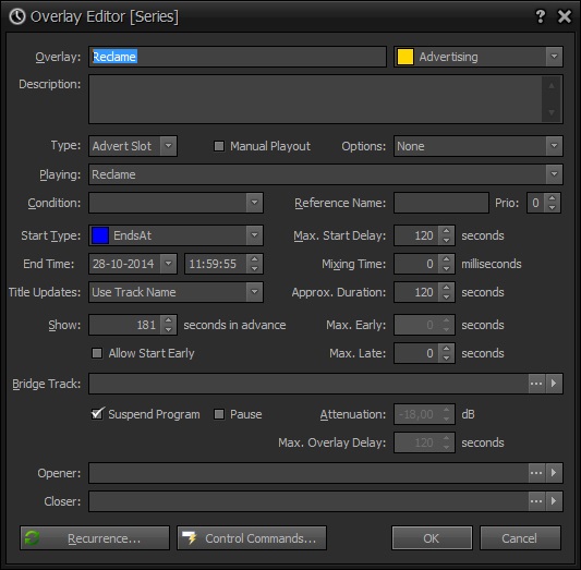

And this are our overlay settings:
This used to work fine, nothing has changed.
Re: Overlay already starts playing when fading out.
Yes, you are right, the combo of StartType = 'EndsAt' or 'Fixed' and MixingTime = 0 indeed had an incorrect segue.
It is now corrected in the new v3.0.14.33!

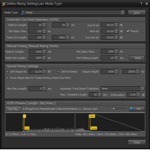

These are my manual fade-out time settings
manual fading.jpg (104.02 KiB) Viewed 11980 times
With your above settings both will play together for 2 seconds!
The playlist track will fade-out for 5 seconds and after 3 seconds the over will start.
I tested at here and got exactly those result! Do you experience something different?
If you get something different...I am sorry, I can not reproduce that here.
If you have the chance please make a video to take a look at.
Else we must do a TeamViewer session in a couple of days...as now I am unavailable due to Christmas time!
What if you directly specify the MixingTime as needed?
E.g. MixingTime = -1500 ms?

First I had mixing time = 1000 for overlay and program.
But this cutted off some audio at the end of the overlay, so I've changed it to '0'
But when it's on 0 now this happens (video)
I want it to fade until the audio from the running track is almost gone and then start the overlay.
