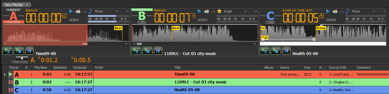

I did the following in my test:
1) The Script looked like this:
1. LoadTrack, C:\TimeSignal.mp3 (around 2sec. long), Count=1, (SuppressHistoryCheck)
2. Cartwall, Jingles (all are 8-10 sec. long), Count=1, (SuppressHistoryCheck), Options=Track Insert Transition 'VO: End with Ramp of Next Track', Attenuation -18.00dB
3.Cartwall, Soundbed (all are 45-60 sec. long and have a Ramp at around 5 sec.), Count=1, (SuppressHistoryCheck)
If you do not want to create (cartwall) libs you might also use LoadTrack for the script-line 2 and 3.
Then for testing do the following:
- Create a new and empty playlist (click on the 'New' ribbon button)
- then in the playlist right-click and select 'Add -> Add Tracks from...'
- in the upcoming dialog select:
. From: Script
. Script Library: your script name as defined above
. How many: One Loop
. As: Individual Tracks
. To: End
- and click OK
- now you should have 3 tracks in your playlist!
- now press AutoPlay to simulate the play out
- the NEXT cue-point of the 2nd track should now be aligned
- the 3rd track gets attenuated til its Ramp position
This is how it then looks when the play out starts...
As said: Currently not working with embedded containers/overlays.
