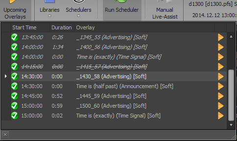

I 've changed the priority of my (same time) overlays but on overlay screen and upcoming overlays the priority with 3 (my commercial overlay) is in front of priority 1 (my time announce overlay).
Can I change this ?
Screenshot 2014-12-12 (1).png (14.67 KiB) Viewed 9066 times
Screenshot 2014-12-12 (2).png (6.93 KiB) Viewed 9066 times

The 'Upcoming Overlay' popup currently displays the list of overlays as is (unsorted). So it doesn't consider the Prio. - as I guess the name is enough to identify them.
Only the Overlay Player considers the Priority and also only in case multiple overlays would have to be combined.
You would have to check the effective time - which is the 'Start Time' and your 'Start Type' and your 'Show in Advance' time...? Last time I looked into them they had been different...Meaning to combine overlays they need to effectively show up at the same time...
