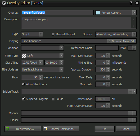

I 've let my program playing, but when the overlay has to start early, it starts at cue out.
Those are my settings:
Re: mixing time
And did those current tracks have a Next cue-point set?
If yes, what time difference is between the Next cue-point and the CueOut cue-point?

The tracks do not have cue-point set. It's auto calculated when they are loaded.
