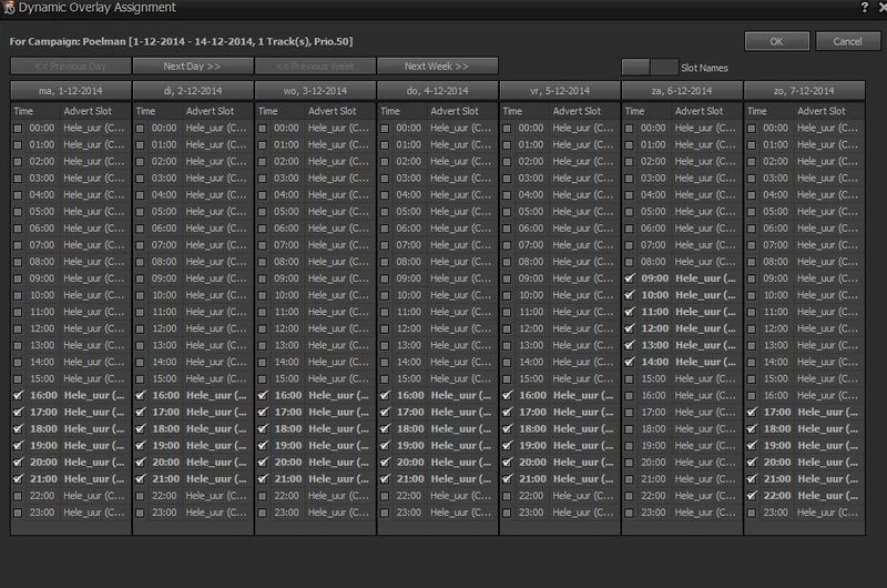

OK I understand that part, but do I have to create all entries for a year manually?
- dynamic-overlay-assignment.jpg (104.96 KiB) Viewed 7845 times
Re: How to add a campaign with different schedule times
I think yesXTended wrote:OK I understand that part, but do I have to create all entries for a year manually?

I was hoping I could use 3 different filters to set it automatically....

Already did copy - past for a year
Thanks I will make a print of your manual
