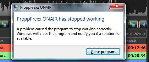

Last night PF stopped working:
20141102 1.jpg (24.86 KiB) Viewed 13354 times
It was v3.0.14.18
Updated to .19 and hope it never happens again.
