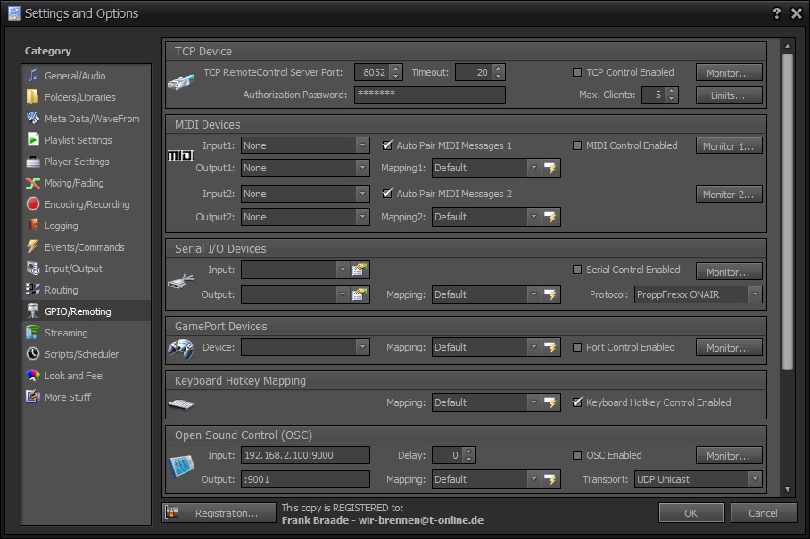

Settings -> GPIO/Remoting -> Keyboard Hotkey Mapping

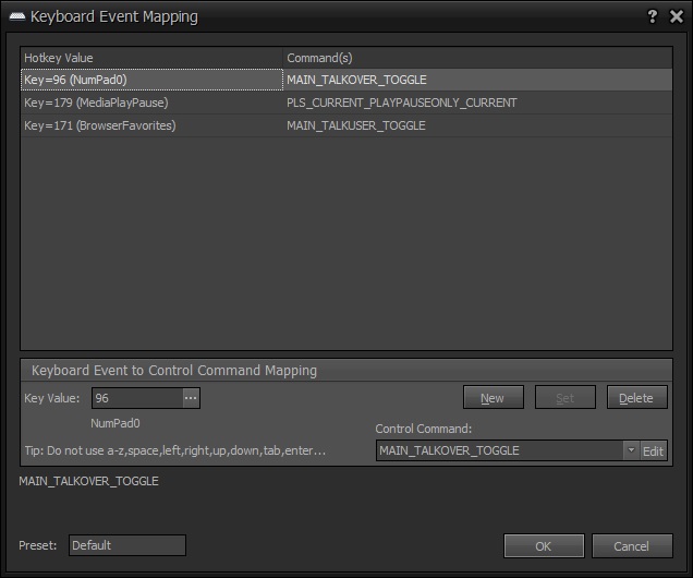

MAIN_TALKOVER_TOGGLE, MAIN_TALKUSER_TOGGLE, PLS_CURRENT_PLAYPAUSEONLY_CURRENT - regardless of what keys I am mapping to these events: doesn't work. Stopped testing here, can't tell wether other events do not work.

The settings as they are:
Inside the mapping is like this:
This was working for a long time and now it isn't anymore. Only things changed: Update of PFOA and (mandatory) Windows-updates.
Aside from mouse and keyboard no other controllers are connected.
settings 1.jpg (150.47 KiB) Viewed 15591 times
settings 2.jpg (56.69 KiB) Viewed 15591 times

With the settings you see in pics: start PFOA, load a playlist (any), hit "autoplay", wait for some time, strike zero (from numberkeyblock) - nothing happens.
start PFOA, hit settings -> gpio -> in keyboard hotkeys section create a new mapping-set -> select it -> hit "OK" -> enter settings again -> gpio -> keyboard... -> hit the "keyboard definition" button -> hit "capture hotkey" -> press a key not mapped to something yet (for example "#" / 191 / OemQuestion) -> OK -> control command hit "edit" -> action dropdown -> select "main_talkuser_toggle" -> hit "new" -> ok -> hit new -> macro appears in hotkeylist -> hit ok -> hit ok -> close pfoa (aka quit).
start pfoa -> check setting wether test-set is selected in gpio / keyboard -> open any playlist -> autoplay -> wait some time -> hit (in this example) the #-key => nothing happens.
