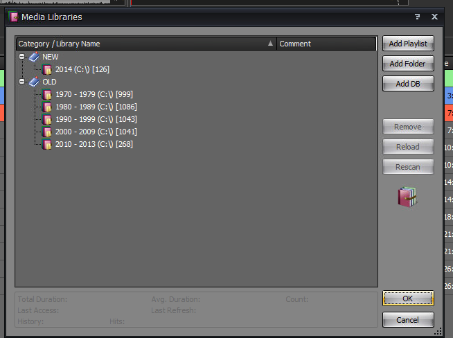

Re: Script erorr
Sorry Bernd,
i try to explain my problem a little better.
This is my Library where you can see NEW and OLD categories.
What i expected i to have 1 song from new category and 1 (random) from one of old subcategories. Now it doesn't work like i exepected because i have sequentially 3 or more OLD and sometimes one new and i don't think it is correct. Before one of hte latest upgrade everything was fine but i can't tell you exactly the moment it start to be wrong.
I hope now is more clear
- propplib.png (72.11 KiB) Viewed 13509 times
Re: Script erorr
Yes what you expect is correct. Even if this has nothing to do with the EXEC MODE.
The 1st line should return a random track from your new lib.
The 2nd line should return a random track from any random old lib.
May be your history settings prevent that?
I.e. the new default is that a script line is skipped if no track can be found from a lib (because all tracks are contained in the history). Except you set a respective script option.
So what is the size of your global history eg is that greater than 126?
And have you probably defined also a history on the libs?
