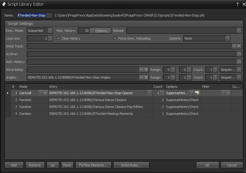

For my non-stop XTended radioshow (no dj show) I like to put a fixed endtune in my script.
So each hour has to end with that tune (just to fill in the last seconds till minutes of the hour).
Is that possible and how to do that?
Attached my script
Attached my script
- Script-settings_XTended.jpg (186.93 KiB) Viewed 7595 times

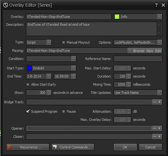

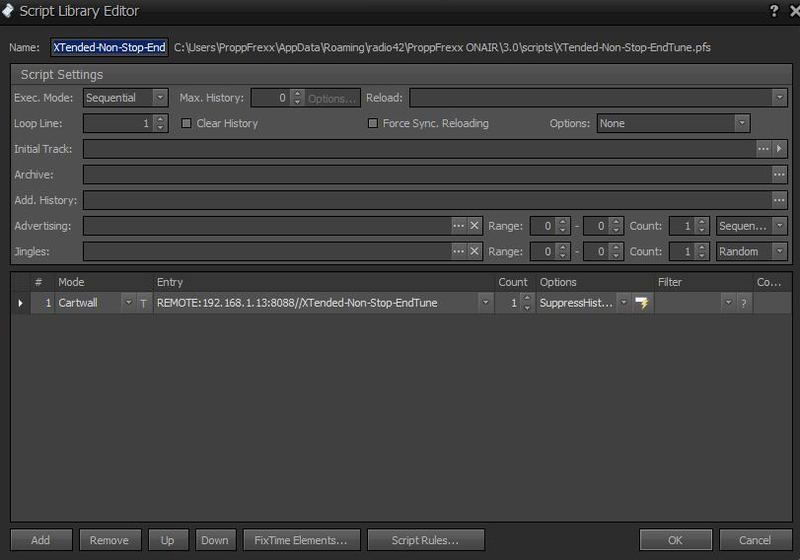

Thanks for your fast answer.
So I created a new XTended-Non-Stop-EndTune PFS script and an overlay.
Are these settings correct (see attachments) ?
- Overlay_editor_settings.jpg (139.74 KiB) Viewed 7591 times
- EndTune-PFS.jpg (144.62 KiB) Viewed 7591 times
Re: How to get a fixed end tune into a script
Yes, if you want that overlay playback to end at exactly16:59:00 - yes.
But I wouldn't set the 'LockPlaylist' option with that overlay?!
OK will switch LockPlaylist off.
Commercials will turn on at 16:58:00.
So this new EndTune overlay must be 16:57:59 ?
XTended
Yes thats correct, I referring to that point.
Ok will test it Bernd!
Have a nice weekend.
It can also directly 'EndAt' 16:58:00!
(I guess you refer to the point that I said, that 2 overlays can not start at exactly the same time)
This is in general true - even if effectively I mean: 'StartTime' minus 'ShowInAdvance' should not be the same.
So if your EndTune-Overlay has a bigger Show in Advance value than your Commercials overlay - all is fine.
