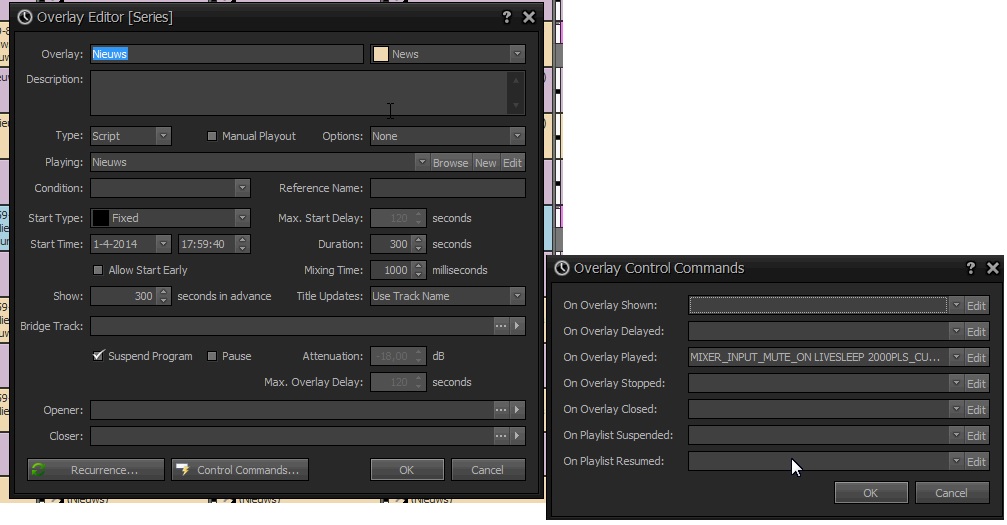

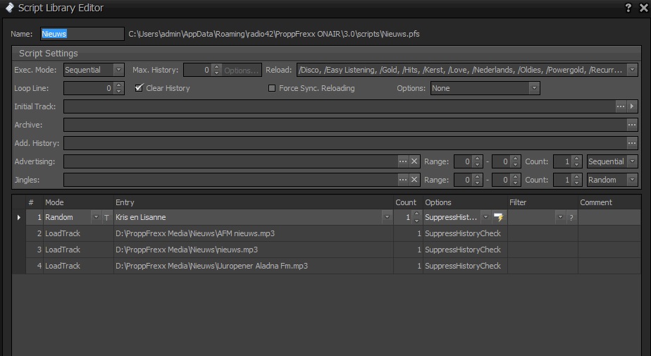

The harddrive is functioning well, but I think something is going wrong in the 3 news tracks or the overlay settings.
I have send the overlay settings screenshot and a script screenshot with this message.
The overlay control commands are:
Mixer_input_mute_on Live
Sleep 2000
PLS_current_close
script news.jpg (96.26 KiB) Viewed 14182 times
overlay nieuws.jpg (111.82 KiB) Viewed 14182 times
Re: Again error in overlay!!
a) the control-commands are executed when the tracks have been played - but we do not even come to that point here, so that can not be the issue.
b) the overlay settings are all fine and could also not lead to the blocking
c) The overlay got stuck when trying to open the tracks for playback.
So the only chance it can get blocked there is as said:
- a locked/blocked file on the OS level
- a corrupt file
- a defect hard disk
I am pretty sure, that this is the only chance...
Btw, a hard disk might work just perfectly fine, up until a defect block is accessed, which could be totally random.
Btw, why do you reload all these media libs with this script (as you are not even using those media libs in this script), looks useless...

AladnaFm
Posts: 111
Joined: 16 Apr 2014 23:29
Post by AladnaFm »
I have did a full check up of the hard drive and there are no damaged sectors.
And i have checked the news download log and everything went fine with the download and the mp3 was copied succesfully to the destination folder.
But one question: I have take another look to the debug log en found the following:
YESTERDAY WHEN THINGS WENT WRONG
8-5-2014 15:54:40: Overlay 'Nieuws@2014-05-08T15:59:40' starts processing.
8-5-2014 15:54:40: Overlay 'Nieuws@2014-05-08T15:59:40' start loading.
8-5-2014 15:54:40: OverlayScheduler: Overlay:Nieuws, Command:News (Nieuws), Start:8-5-2014 15:59:40 processed
8-5-2014 15:54:40: Overlay 'Nieuws@2014-05-08T15:59:40' ProgressChanged State=0.
8-5-2014 15:54:40: Overlay 'Nieuws@2014-05-08T15:59:40' starting LoadScript.
8-5-2014 15:54:40: Processing Script-Line 1 (Retries=1000): 1 Random : Kris en Lisanne (Filter=, Options=SuppressHistoryCheck)
8-5-2014 15:54:40: GetNextTracks processed, 1 script result entries returned (File=D:\ProppFrexx Media\Reclame\Kris en Lisanne\Spot-Kris-en-Lisanne-voice-Jeroen.mp3).
8-5-2014 15:54:40: Processing Script-Line 2 (Retries=1000): 1 LoadTrack : D:\ProppFrexx Media\Nieuws\AFM nieuws.mp3 (Filter=, Options=SuppressHistoryCheck)
8-5-2014 15:54:40: GetNextTracks processed, 1 script result entries returned (File=D:\ProppFrexx Media\Nieuws\AFM nieuws.mp3).
8-5-2014 15:54:40: Processing Script-Line 3 (Retries=1000): 1 LoadTrack : D:\ProppFrexx Media\Nieuws\nieuws.mp3 (Filter=, Options=SuppressHistoryCheck)
8-5-2014 15:54:40: GetNextTracks processed, 1 script result entries returned (File=D:\ProppFrexx Media\Nieuws\nieuws.mp3).
8-5-2014 15:54:40: Processing Script-Line 4 (Retries=1000): 1 LoadTrack : D:\ProppFrexx Media\Nieuws\Uuropener Aladna Fm.mp3 (Filter=, Options=SuppressHistoryCheck)
8-5-2014 15:54:40: GetNextTracks processed, 1 script result entries returned (File=D:\ProppFrexx Media\Nieuws\Uuropener Aladna Fm.mp3).
8-5-2014 15:54:40: Overlay 'Nieuws@2014-05-08T15:59:40' LoadScript 4 Script-Tracks found.
8-5-2014 15:54:40: Overlay 'Nieuws@2014-05-08T15:59:40' LoadScript finished 4 Total-Tracks (00:03:17.2090000 Playtime).
8-5-2014 15:54:40: Overlay 'Nieuws@2014-05-08T15:59:40' finish loading.
8-5-2014 15:54:40: Overlay 'Nieuws@2014-05-08T15:59:40' starting (4 Tracks).
TODAY WHEN THINGS WORKS FINE
9-5-2014 7:54:37: Overlay 'Nieuws@2014-05-09T07:59:40' starts processing.
9-5-2014 7:54:37: Overlay 'Nieuws@2014-05-09T07:59:40' start loading.
9-5-2014 7:54:37: OverlayScheduler: Overlay:Nieuws, Command:News (Nieuws), Start:9-5-2014 7:59:40 processed
9-5-2014 7:54:37: Overlay 'Nieuws@2014-05-09T07:59:40' ProgressChanged State=0.
9-5-2014 7:54:37: Overlay 'Nieuws@2014-05-09T07:59:40' starting LoadScript.
9-5-2014 7:54:37: Processing Script-Line 1 (Retries=1000): 1 Random : Kris en Lisanne (Filter=, Options=SuppressHistoryCheck)
9-5-2014 7:54:37: GetNextTracks processed, 1 script result entries returned (File=D:\ProppFrexx Media\Reclame\Kris en Lisanne\Spot-Kris-en-Lisanne-voice-Hannelore.mp3).
9-5-2014 7:54:37: Processing Script-Line 2 (Retries=1000): 1 LoadTrack : C:\Nieuws\AFM nieuws.mp3 (Filter=, Options=SuppressHistoryCheck)
9-5-2014 7:54:37: GetNextTracks processed, 1 script result entries returned (File=C:\Nieuws\AFM nieuws.mp3).
9-5-2014 7:54:37: Processing Script-Line 3 (Retries=1000): 1 LoadTrack : C:\Nieuws\nieuws.mp3 (Filter=, Options=SuppressHistoryCheck)
9-5-2014 7:54:37: GetNextTracks processed, 1 script result entries returned (File=C:\Nieuws\nieuws.mp3).
9-5-2014 7:54:37: Processing Script-Line 4 (Retries=1000): 1 LoadTrack : C:\Nieuws\Uuropener Aladna Fm.mp3 (Filter=, Options=SuppressHistoryCheck)
9-5-2014 7:54:37: GetNextTracks processed, 1 script result entries returned (File=C:\Nieuws\Uuropener Aladna Fm.mp3).
9-5-2014 7:54:37: Overlay 'Nieuws@2014-05-09T07:59:40' LoadScript 4 Script-Tracks found.
9-5-2014 7:54:37: Overlay 'Nieuws@2014-05-09T07:59:40' LoadScript finished 4 Total-Tracks (00:02:57.0050000 Playtime).
9-5-2014 7:54:37: Overlay 'Nieuws@2014-05-09T07:59:40' finish loading.
9-5-2014 7:54:37: Overlay 'Nieuws@2014-05-09T07:59:40' starting (4 Tracks).
9-5-2014 7:54:37: Overlay 'Nieuws@2014-05-09T07:59:40' PrepareOverlayStream (4 Tracks, Duration=00:02:57.0050000).
9-5-2014 7:54:37: Overlay 'Nieuws@2014-05-09T07:59:40' prepared.
9-5-2014 7:54:37: Overlay 'Nieuws@2014-05-09T07:59:40' DoPlayOverlay started.
9-5-2014 7:54:37: Overlay 'Nieuws@2014-05-09T07:59:40' ProgressChanged State=1.
Notice when things went WRONG YESTERDAY the following script lines were NOT processed:
Does this have to do with the mp3's or something else??
And the overlayplayer was already showing the player with the 4 tracks and already was counting down for a minute.
And suddenly at 5 minutes to go, it went stuck and it shows loading instead of waiting.
Greetz
Jesper, Aladna Fm
Yes of course, that is the difference in the logs!
And tat the reason, why I believe, that something must go wrong with the downloaded mp3's.
The reason, why there are missing debug log entries is, that is got stuck.
That actually shows us/me the exact position where something went wrong and where it got stuck!
Meaning exactly between these two log-lines:
1) 9-5-2014 7:54:37: Overlay 'Nieuws@2014-05-09T07:59:40' starting (4 Tracks).
2) 9-5-2014 7:54:37: Overlay 'Nieuws@2014-05-09T07:59:40' PrepareOverlayStream (4 Tracks, Duration=00:02:57.0050000).
And inbetween these two log-lines the only thing done is opening the mp3s for playback, nothing more!
And that means, that the opening of the files got somehow blocked...
