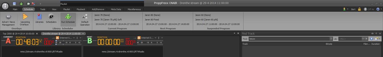

Found something strange: in my Administrator Bert account view the scheduler shows programs in the past (see picture).

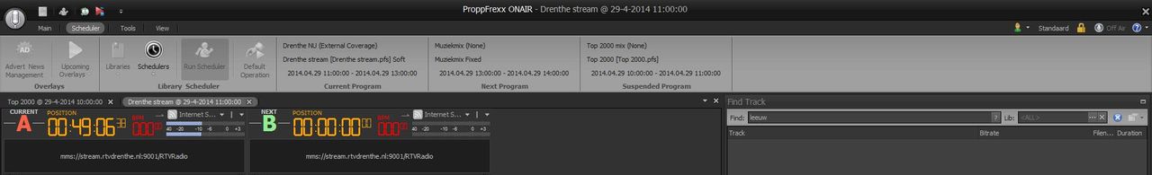

And at the same time when I log off from Admin view to Standard Operator view the scheduler shows the right programs (see picture).
How is that possible, but more important is it a bug?

- Scheduler_past_admin-view.jpg (39.49 KiB) Viewed 5196 times
- Scheduler_good_standard-view.jpg (38.67 KiB) Viewed 5196 times
Re: Something strange in scheduler view: going back in the p
please try to delete a file called "ProppFrexx ONAIR.Admin.ribbon" and try again.
You might delete that file once in Standard view...and then try again.
There was once a bug in the UI lib I am using causing that, but if you are using the latest version that should then be fixed.
OK I will remove that file ProppFrexx ONAIR.Admin.ribbon .
