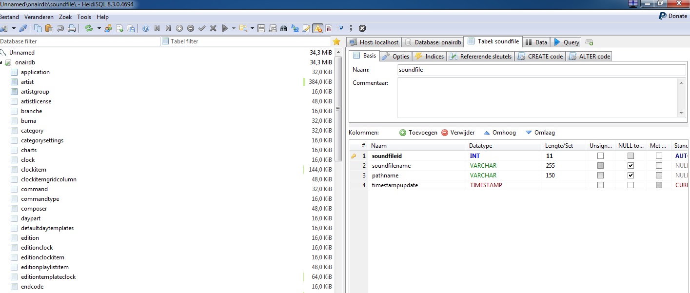

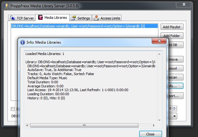

I have 3 questions about the database.
1) I have installed on my pc mysql 5.6 community server where I have imported the backup.
Everything is running correctly now (see below pic), but the tracks are 0.
Is there something wrong with the connection?
2) What is the setting about my table view of database ?, How can I set it right to view the right tables?
3) In the settings of proppfrexx there is a line called metadata/Tag database. Is this also working
with mysql or is this standalone mapping?
Greetings Frank

Re: A view Questions
As said, you find the view in Appendix of the User Manual!
There is also a file called SQL.txt being installed to your ProppFrexx installation folder.
The connection looks okay so far. Are you sure that your table/view contains any rows?
Does the view actually contains at least a LOCATION column?
and does that LOCATION column contain the file names of the physical audio files?
What happens, if you click on the Test button in the Edit Database Library dialog?

1) The database looks like (see pic below) DB onairdb. I don't know if this information is enough.

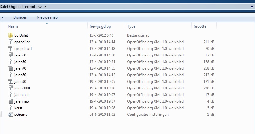

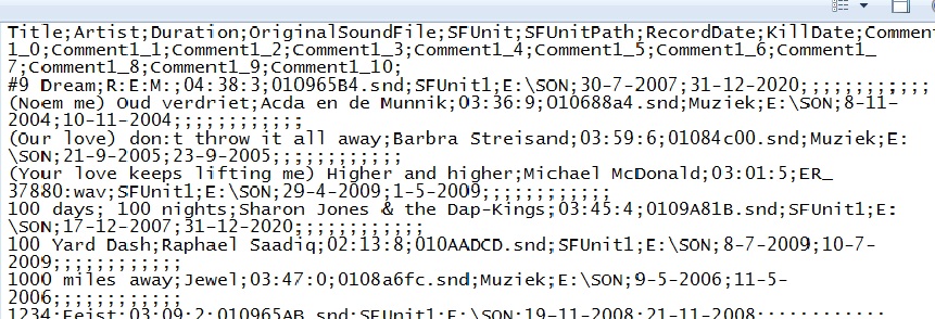

2) I don't know if I need a DB. We have an export CVS (see pic) from a dalet station with 30.000 titles with location of the soundfile.
The information in the csv file (see pic) is what you are looking at! The dalet map is where all the files are stored in (see next message)
3) Is this simple to import to Proppfrexx?

Let me explain al lot to you sorry for no information.

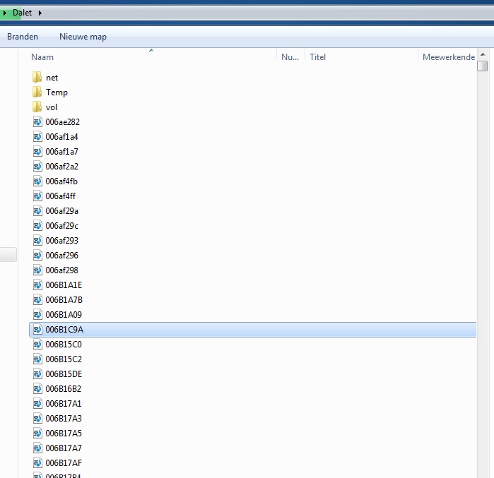

This is where all the soundfiles of dalet are stored.
- Map dalet.jpg (63.63 KiB) Viewed 24732 times
I don't know the onairdb.
Do you happen to have a full database export to take a look at.
From the CSV export I can basically see, that an import should in general be possible. But the cvs export also seems incorrect, e.g. When looking to the line starting with "100 days; 100 nights..." there is a ; too much in that line, probably because the Title already contains one.
All the other table names etc. tell me much.
From which system does this data come from.
The CSV export also doesn't contain much meta data...so have you tried to just create a folder based media lib using your main folder containing all your tracks?
If yes, what meta data are you missing which is contained in the onairdb?
