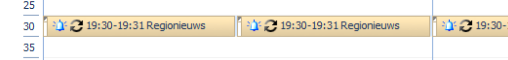

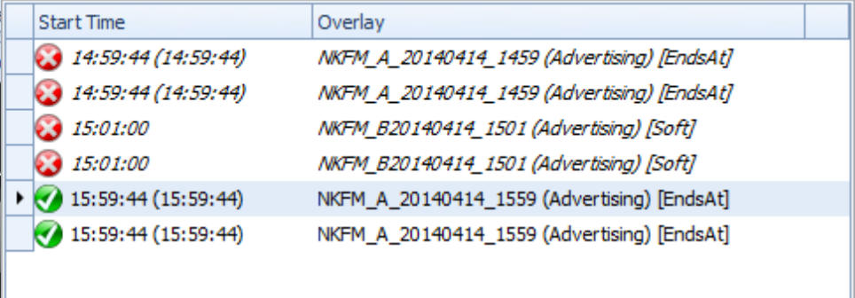

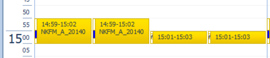

Just one thing : i recreated the overlays, but when I have a look in the overlay schedule, they are displayed double ? It's not easy to see in the picture, but they are exactly the same.
It seems like my overlay calendar is CENSORED up, don't you think ?
Re: All overlays -> Gone
Then they do exist twice in the calendar?!
what happens, if you remove/delete one of them?
andrerotgans
Posts: 192
Joined: 27 Nov 2012 13:23
Post by andrerotgans »
then it is deleted (only one of them)

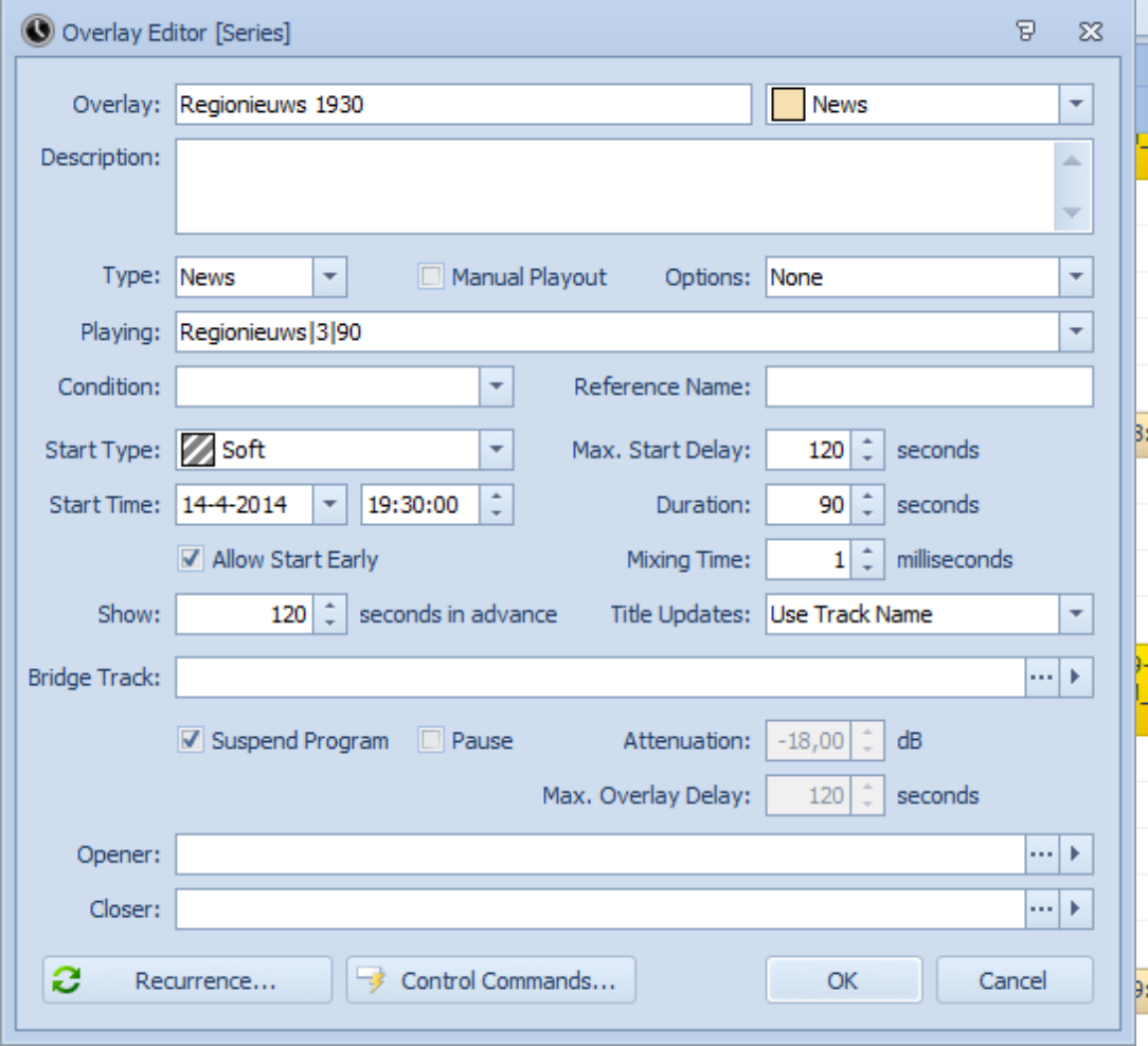

I just created some news overlays, they come 'in two' also. But, I wanted to adjust something, and, when I opened it and adjusted (mixing time, but that doesn't matter), it came back as only one overlay. Strange !

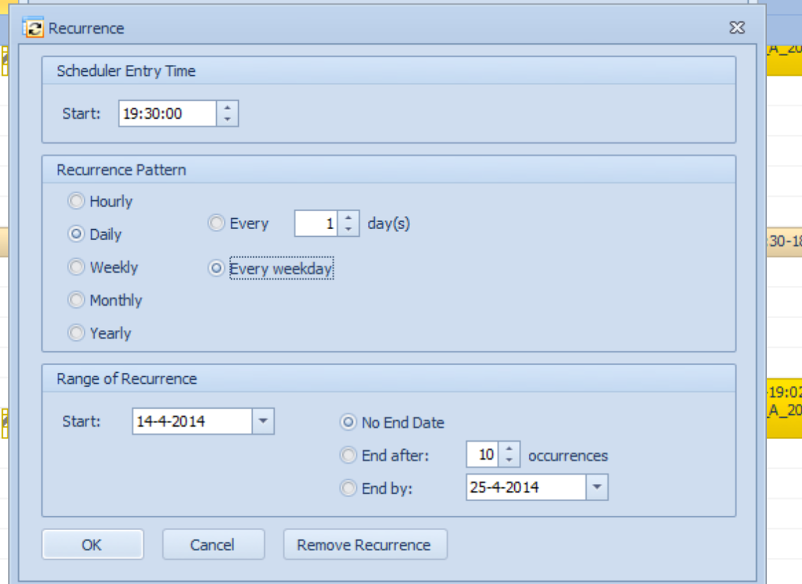

here are some screenshots of the news-overlay bug, mentioned above
STEP 1.png (243.48 KiB) Viewed 14102 times
STEP 2.png (167.88 KiB) Viewed 14102 times
RESULT 1.png (38.22 KiB) Viewed 14102 times
andrerotgans
Posts: 192
And after an adjustment (see the changed mixing time), it's ok !
FINAL RESULT.png (31.04 KiB) Viewed 14101 times

Some lines from the logfile :
14-4-2014 14:29:25: ERROR: Calendar 'H:\Advertising\Overlay.calendar' could not be read! Lock could not be aquired.
14-4-2014 14:29:26: ERROR: Calendar 'H:\Advertising\Overlay.calendar' could not be read! Er is al een item met dezelfde sleutel toegevoegd.
14-4-2014 14:45:50: ERROR: Calendar 'H:\Advertising\Overlay.calendar' could not be read! Er is al een item met dezelfde sleutel toegevoegd.
14-4-2014 15:15:25: Calendar 'H:\Advertising\Overlay.calendar' updated (last modified: 14-4-2014 15:11:05)
and I get a lot of warnings (from older overlays, not being played), but also a warning telling me this :
14-4-2014 15:15:36: WARNING: Scheduler-Exception:'Failed to compare two elements in the array.'!
Never seen that one before ?
