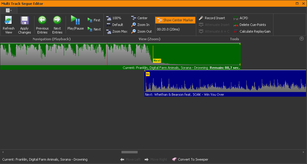

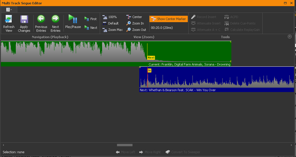

This isn't a beat matching problem. if I refer to beat 1 there's a good reason. frequentely, a track got some sound starting "off beat" before the beat 1. the exact need is to be able to play this little "off beat" introduction before the cue in that is supposed the place to be in "sync" with the "next point" of the previous track. so to be able to achieve this at the moment you need to now the exact amount of time beetween the real start of the sound you want to play off beat and the wanted "cue" that you want to be played at next of the previous track.
in the screen caps, you can see that when you have the correct wanted transition(cue in off beat), you are visually lost cause you don't see any marker.

I took some time to think about this in the last hours. As it supposed to be "cue in" must be cue in (effective start). so maybe a new marker is the easiest solution, something called "cue mix" that, if exists, would sync to the next of the previous track.
Re: New mix settings
In that case you should use the already existing MixIn feature of the media entry type.
E.g. go to the general settings, section Mixing and click on the Mixing per Media Type button...
Now select a media type, e.g. User1.
As the MixIn mode select CueInStartAtZero.
And save this.
Now you can place your CueIn position to your 1st beat! Plus specify the media type of that track to User1.
That’s it. No need to specify an additional negative offset.
