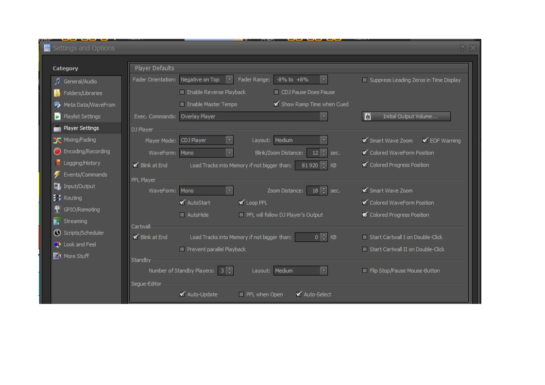

Now, after reinstal PFOA...
Re: New mix settings
And it is not automatically updating when you select a different track in the playlist?
I.e. normally selecting a track in a playlist will also select the sub-sequent one and both are shown in the Segue-Editor?!

If I click on another song in the playlist, the seque editor just blinks and nothing happens. I have to click refresh directly in it.
Strange. I need to look at it when I am back from vacation in August!
