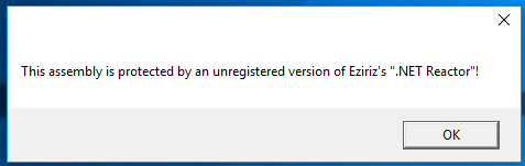

Thank you. I'm going to test it. But after update I get this error. Three times I must confirm window, than PFOA starts...
- error.png (8.49 KiB) Viewed 16643 times

That's strange.
I'll take a look what went wrong in the build process...

Just made a rebuild and provided a new v4.0.1.64-beta!
So please update again...
(I updated my motherboard bios today and that invalidated a certain lib's license

Upgraded. It's OK now... Thank you and have a nice week...
