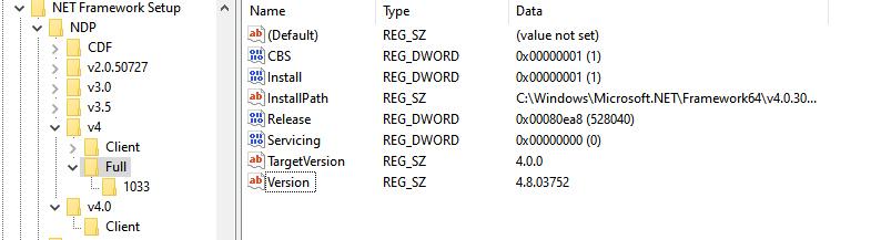

Net. Framework V 4.8.03752
I am wondering if there is a conflict outside of PF that is preventing me from connecting to the SHOUTcast server as I've now tried to connect to the server with WinAmp and that also says there is an error.
