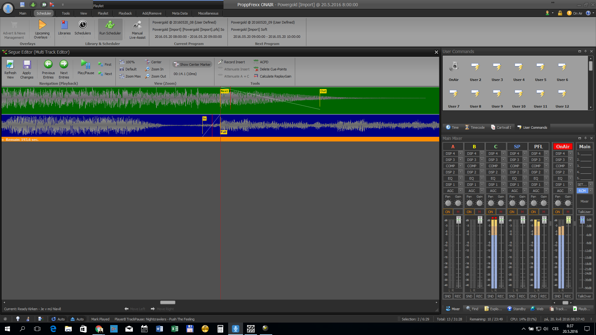

I'm testing FullIn as MixIn option and sometimes it's OK, sometimes Next point of previous track moves, even if FullIn of following is not set, to Promo media type setup does not respond, sometimes Seque editor show mix correctly, but the result of this takes place as a cue-in default settings... See pic.
- seque.png (194.53 KiB) Viewed 16206 times

Songs that I send, have set up Full point. On the screen is all OK, but If you play this mix in seque editor, next song will play once it reaches Next point od previous track. It can be seen on the red courses. Next point of previous track is not move.
A few times I've seen shifted next point of previous track, even if FullIn of following is not set

Ok, but final mix looks like CueIn (default) setting...
