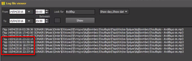

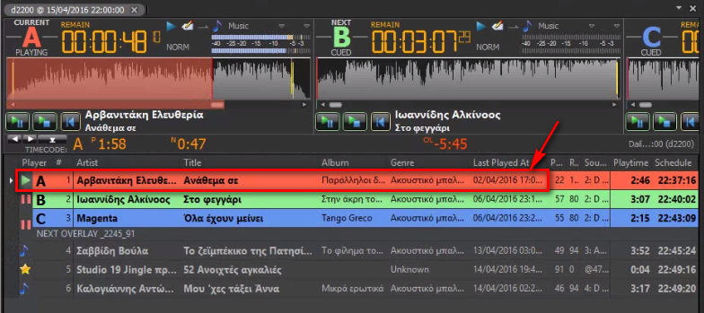

Bernd, there is still a problem.
It doesn't play artists back to back but it doesn't keep the last played time correctly.
Look at the screenshots.
Keep in mind that I updated to v4.0.1.24 yesterday night.
Re: Same artist back to back - History check
Yes, that might be related, as the 'Artist' was not transmitted correctly, the entry statistic might also have been going wrong in the same way - using an entry in the stats 'without' the artist... so just wait one or two days and the stats should be from now on fine again...

The problem is not at the statistics.
The real problem is that the song repeats too often.
