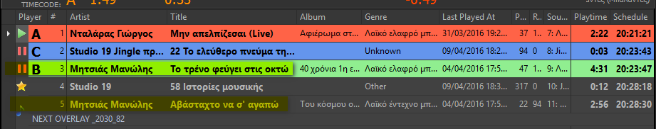

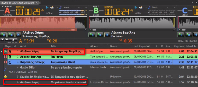

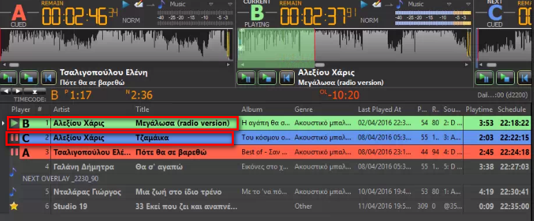

I have also set to display the Source info column.
Both tracks come from the same script line. (It has count of 2). But other times can be from different script lines.
Look at the screenshot:
and later again:
and again:
I am desparate.

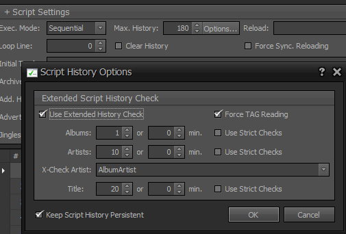

Re: Same artist back to back - History check
...hard to see, as only the first columns are different.
So what is your global history count setting in the general settings - or are you only using script based history settings...?
Can you please send me two of those different tracks which looks like they have the same Artist to make some tests over here, as it looks all good what you have configured!
