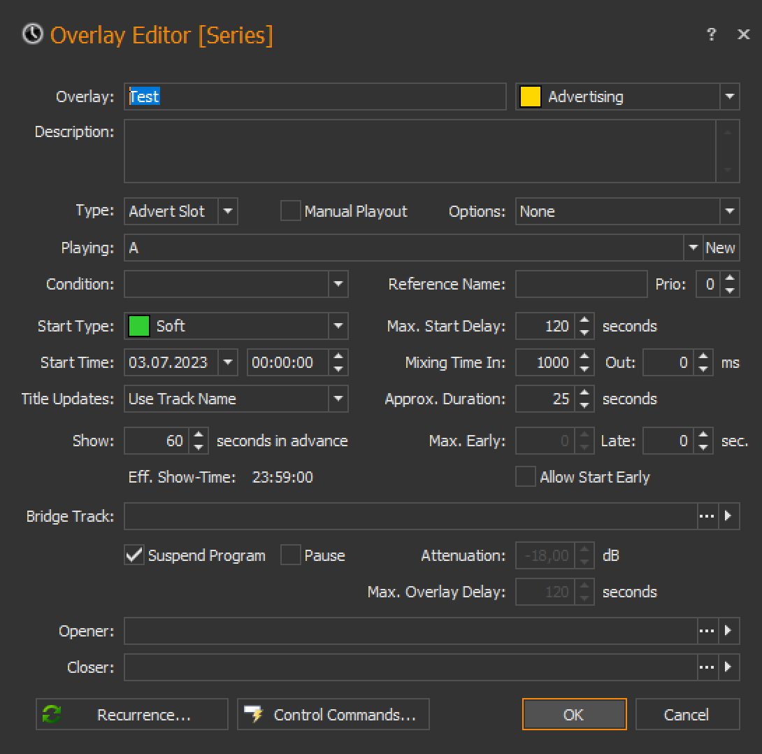

In the Overlays Scheduler you now define overlays. An overlay can 'play' a slot. I.e. all assigned campaigns will be played in that overlay.

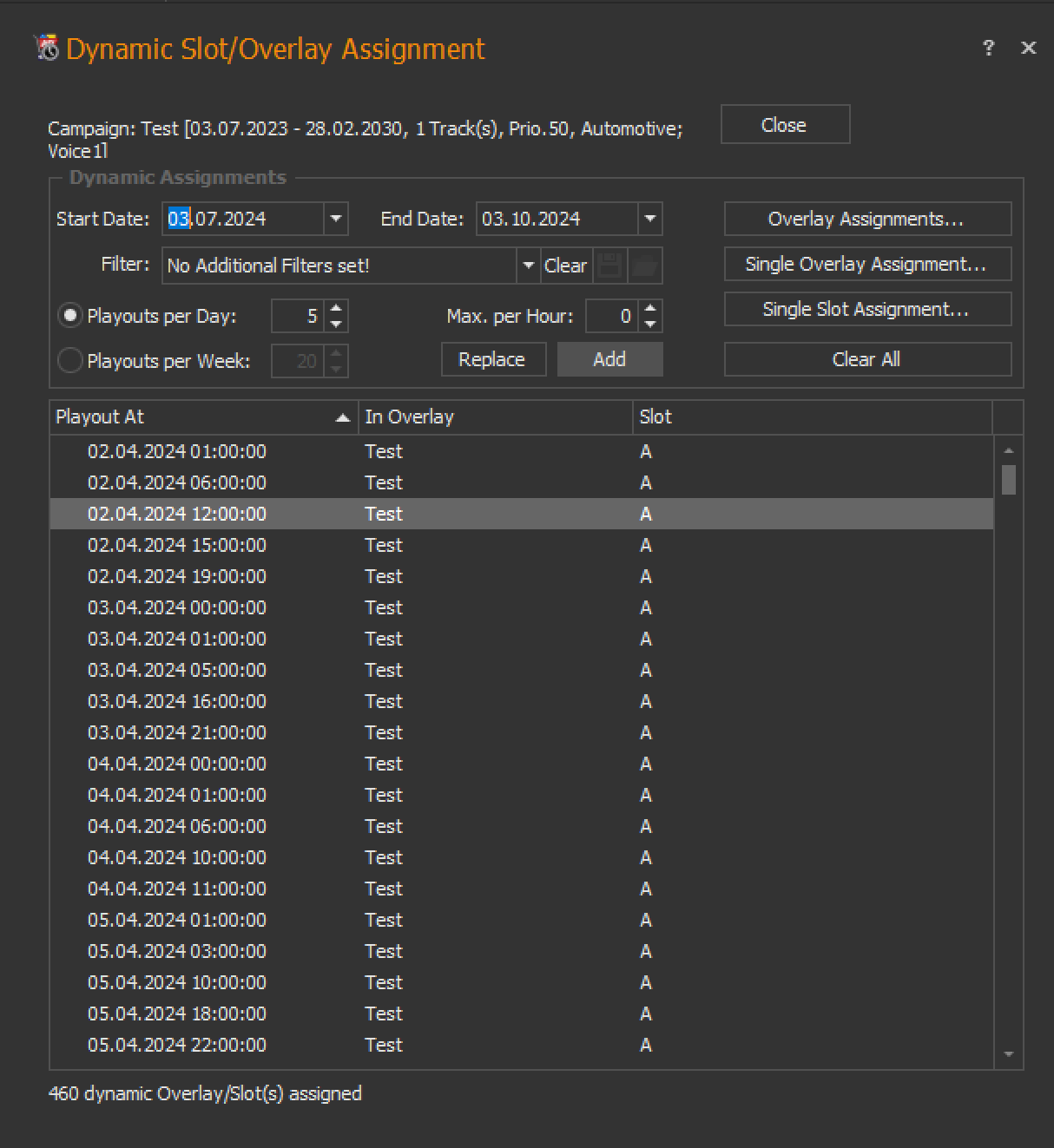

On this example the Slot with the name "A" is assigned to an Overlay with the name "Test".
You can now assign Campaigns directly to a Slot. In such case, the campaign is always played in that slot.
The dynamic assignment function is special in such way, that you can assign a campaign to specific instances of a slot. I.e. you assign a campaign to an instance of a slot for a specific overlay at a specific date. I.e. the campaign will only be played on that specific overlay instance/date and time. The slot must still be assigned to that overlay!
The assignment is dynamic in the way, that you can specify how you like to distribute the assignment to the overlay instances.
In the example above 460 assignments are define, 5 per day in the tie range from 3.7.2024 til 3.10.2024.
Make sure to press the 'Add' button to actually perform the assignment.

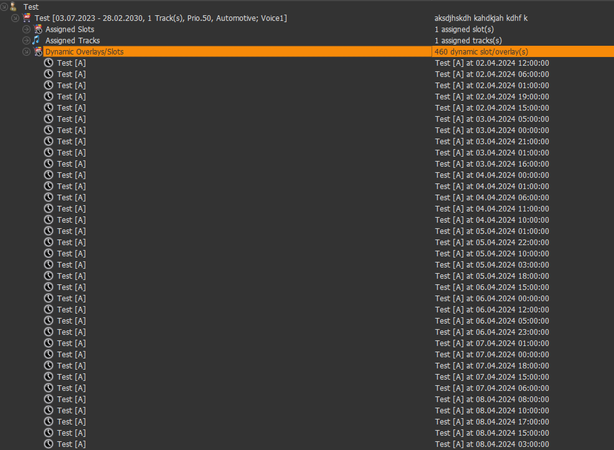

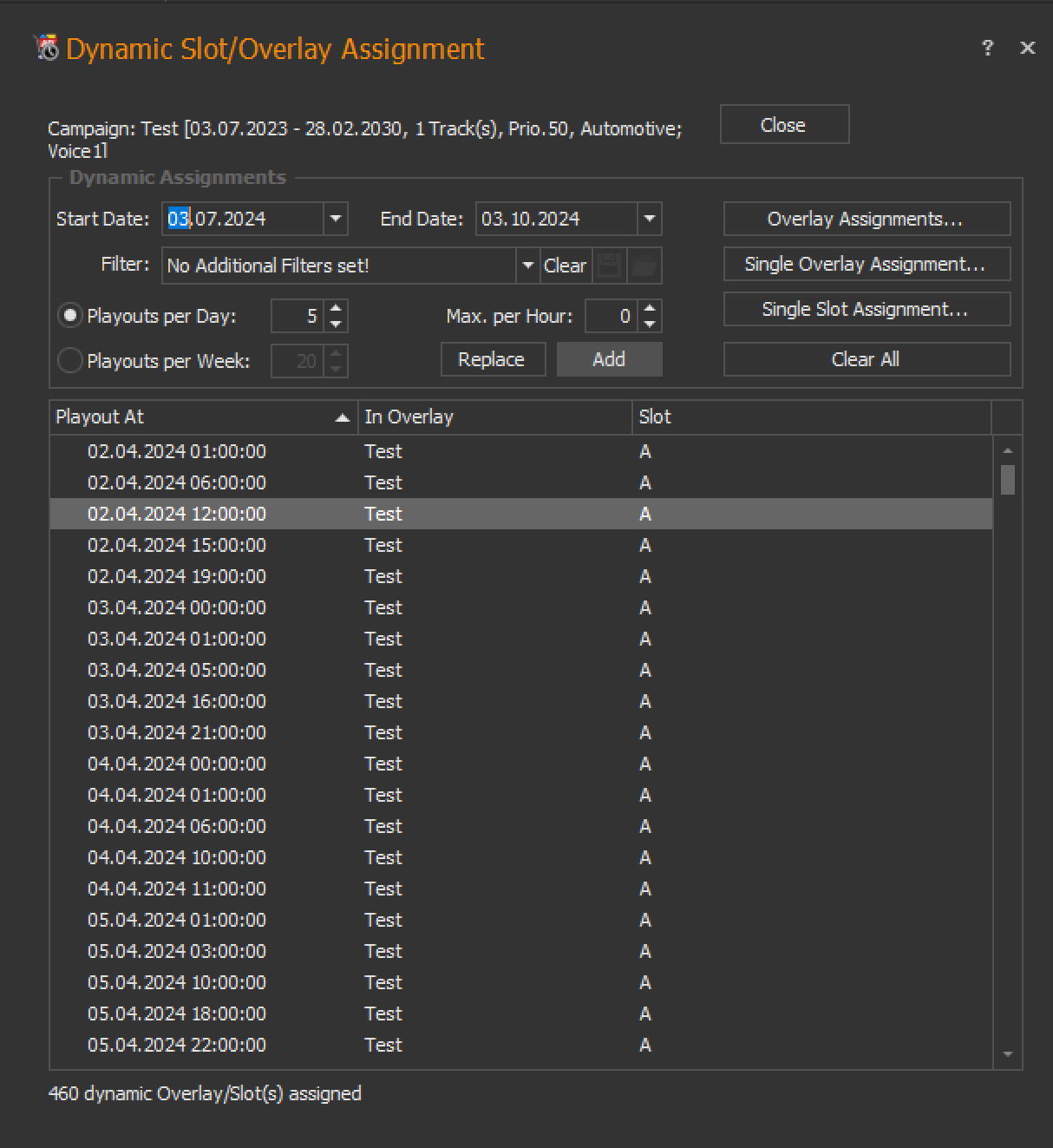

Once done, you will also see those dynamic assignments in the overall tree view:
I just tested it here again - and all is working. So I assume, that something is not assigned properly in your case.

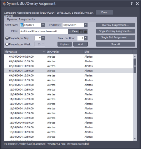

I think I misspoke, but I believe that's exactly what I did.
Example:

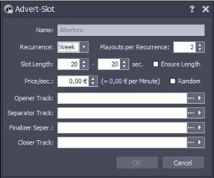

I created this slot:
I created a campaign that I assigned to this slot with filters to play this campaign only on Thursdays within a time range:

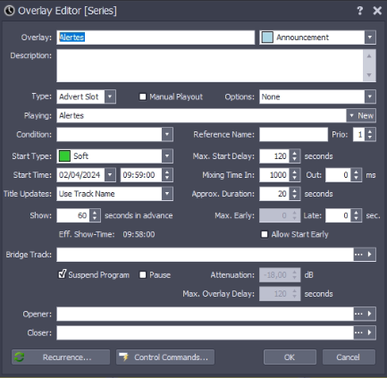

I created an overlay on which I selected the same slot.

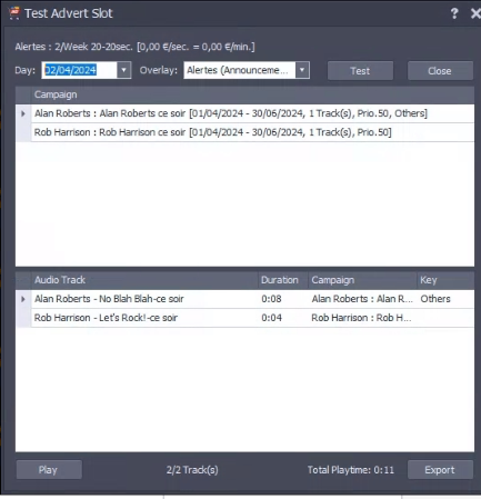

And here is the result (here using the test overlay function, but this is what was played) in reality.
As you can see, PF has scheduled and played this message today, Tuesday!
Re: Scheduling a recurring show
So what is effectively wrong?
The campaign "Alan Roberts ce soir" is being played - just as you assigned it!
Note, that only one track from one campaign is being picked of course.

I don't want this campaign to be played on Tuesday because it's scheduled for Thursday! So why is PF also playing it on Tuesday? And it's the same for all the campaigns I've scheduled. Bug or mistake on my part?

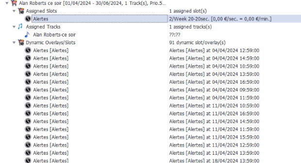

Have you maybe also selected and assigned the campaign direct to that slot?
Please show how your campaign tree looks like - maybe there are entries under the 'Assigned Slots' node (e.g. you not only have dynamic assignments)?
claudius06
Posts: 193
Joined: 25 Nov 2023 09:23
Post by claudius06 »
Here is:
Is this what you're talking about?
