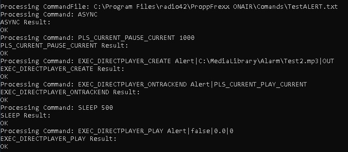

Now we tried to execute the commands you wrote through the pfremcmd.exe console, after saving the text of the commands in a TXT file, the execution code in the screenshot:

Re: Automatic air alert
Yes, if you use plain TCP socket communication, you need to apply the AUTHORIZATION command (pfremcmd.exe does that for you already, so you only send the effective commands).
But the other conditions, e.g. no quotes ("), no blank lines etc. are still valid.

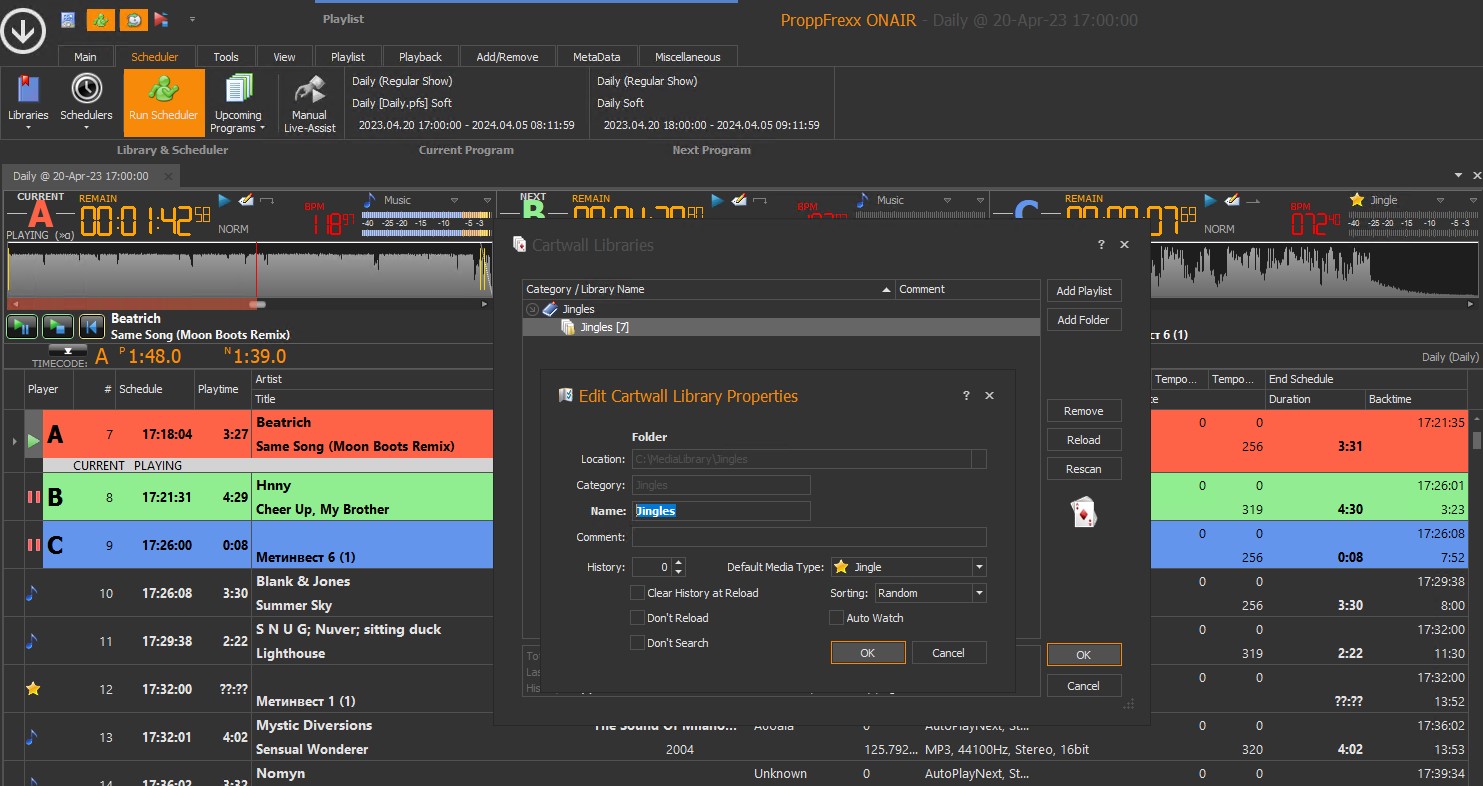

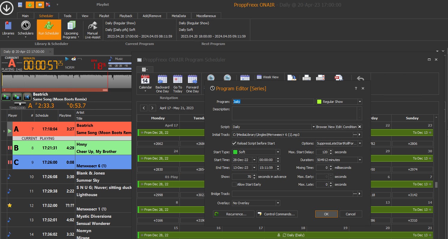

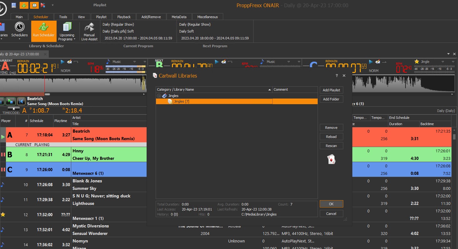

In addition I add screenshots how we organised our air
I can hardly follow your description resp. can not link your screenshots to the issue who h you have.
Please send me your exact command sequence you execute. If you use the above command-line tool and execute from a file, that file is maybe sufficient.
What I understand, is that your playlist is not stopped, but the next track continues to play?!
Have you tried executing tue commands via the User-Commands window to test it as well?
