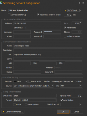

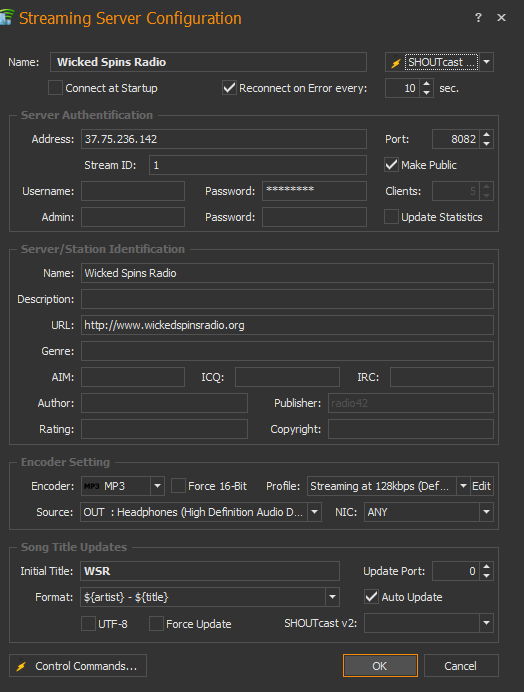

Yes, having the encoder set to start on startup was what was causing PF to shut down straight away. When I reinstalled and set the new encoder I up unchecked that box and that allowed me to start troubleshooting. Now when I try to connect I just get (An Unkown error occurred) and only once since then has it shut PF down on trying to connect
MP3 streaming at 128kbs

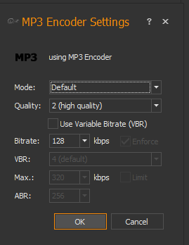

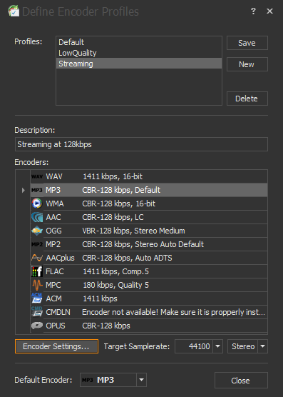

Re: ProppFrexx has stopped opening.
Can you also show the encoder profile setup ?!
And are you using the default lame.exe encoder?
I am asking, since all is working fine for many hundreds of users - so something must be different in your setup and usage.
Probably related to your previous v3 setup?!

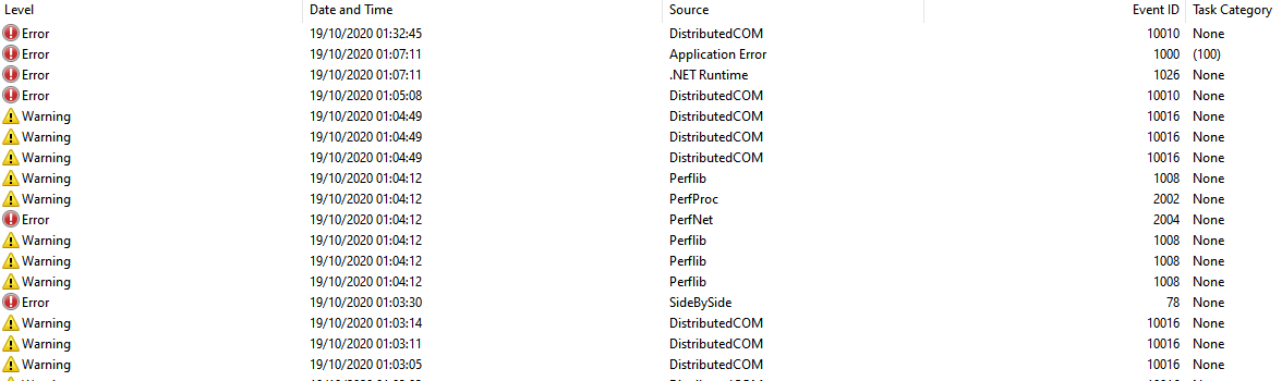

I'm not sure if any of this will help or if they are related but these event logs were all created when trying to connect to the server prior to PF shutting down.
This was before I got it stable to just report an unknown error msg in PF that I get now.
Are you using a SHOUTcast v2 server?
As you have currently configured to use a v2 server.
Or is it maybe a SHOUTcast v1 server?
If yes, remove the ‚Steam ID‘ from the Server config.
Also make sure you have the latest .Net framework properly installed, e.g. at least 4.8.
