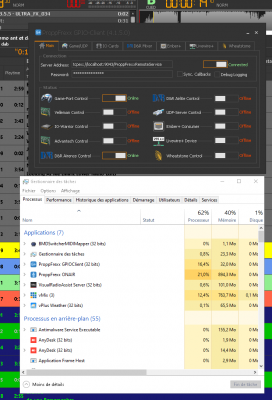

13% is exclusively the GPIO use
Now My cpu use is stable around 23% for proppfrexx when using and as you described a lot less without Stereotools. but 13% for GPIO seems a lot only for arduino that is joystick like, and airence commands.

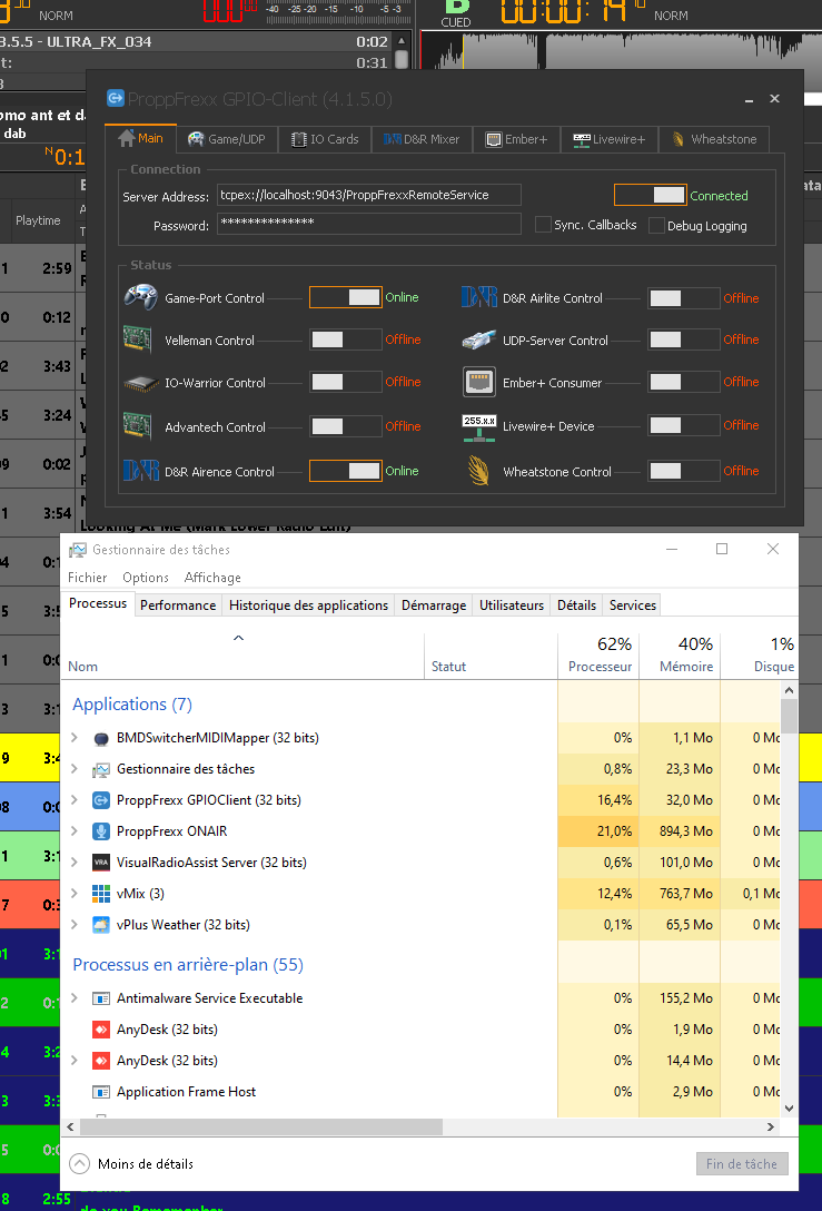

no matter my system.... look at the picture, Gpio is using far more than the half of the cpu usage of PFOA with Stereotools respectively 16% for 21% isn'it a lot?

You can try to disable your interfaces one by one to determine which of the 2 is consuming the CPU inside the GPIO client. Start with the Gamepad interface and see if the CPU usage drops. Then do the same with the D&R Airence...
You can also try to open the 'Monitor...' of the resp. interface in the detailed tab, so see, if maybe one interface sends incomming messages like crazy...

I just add a quick remote connection to the computer to check that.. seems to be the airence.. I think maybe it comes from the cartwall buttons configuration that I've never been able to configure exactely as I'd like to be.
