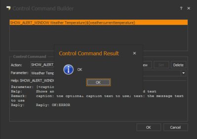

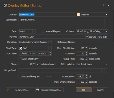

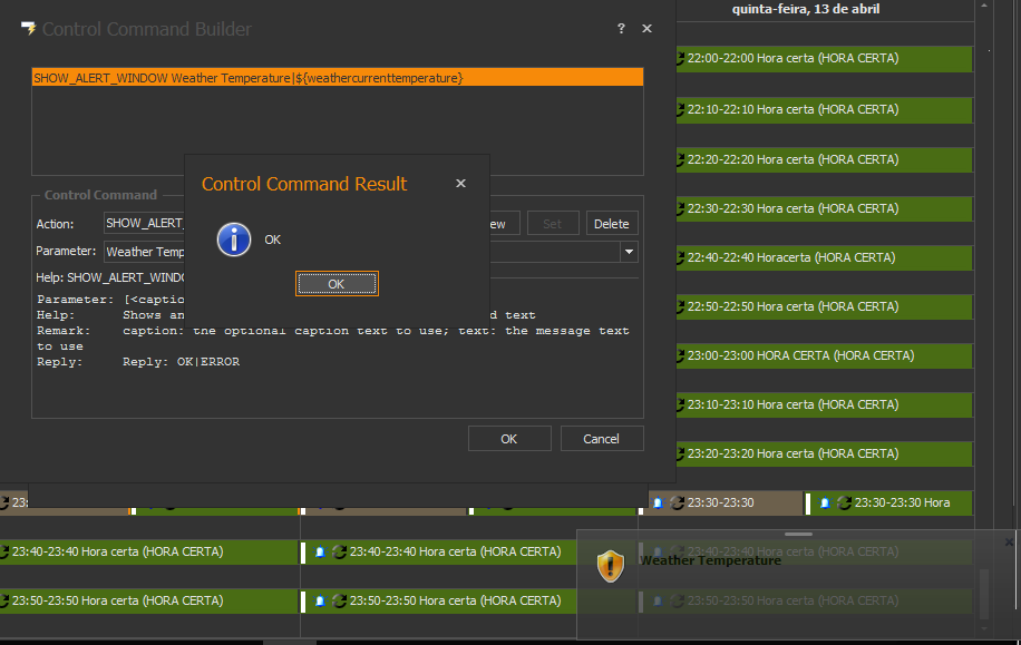

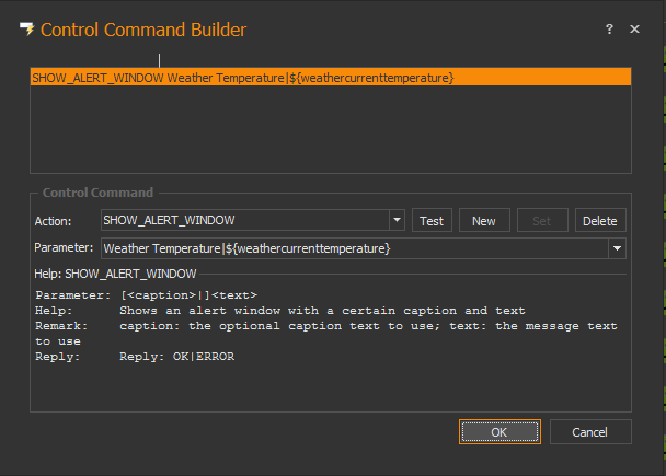

I really do not think I knew how to express myself, I apologize and I would like you to look at these images, I followed everything as you told me.

Realmente acho que não estava sabendo me espressar peço desculpas e gostaria que olhase para estas imagens segui tudo conforme você me disse

Why do you not listen to what I suggest?!
Instead you always do something new and different.
So again:
Open a new and empty playlist.
Then just right-click into the playlist and select 'Add -> 1 random Track -> Script -> yourscriptname)...
And what filename was resolved to the playlist?!
And can you play this item?
After we successfully tested this scenario we can continue.
But I believe that this is already failing, because your FileName a are not matching!
So please test the above first !
