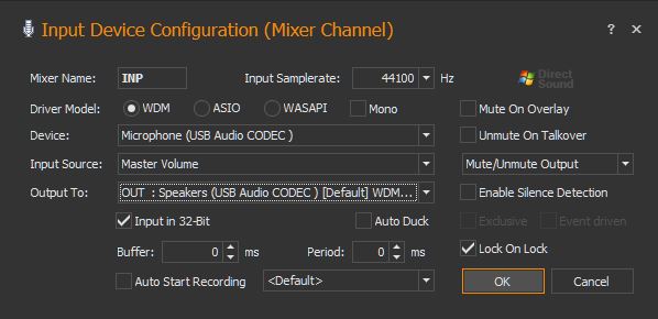

2 – MIC – the only way to get MIC output is using the “Output To: OUT:Speakers…” in INP channel (please take a look to the picture). Of course, as you wrote, set any value for “Output To” create a feedback loop, no doubt. This means I cannot use this option and the result is no MIC output signal!

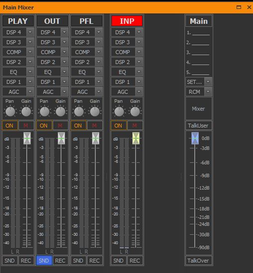

3 – The Main Mixer configuration (as shown in the picture) was obtained using, one more time, the “Tools/Mixer Setup Wizard/5. External Mixer External Microphones (Complex)”. Also was created by default a MON Channel that I removed because it was empty. I am not quite sure if I need to use the “Tools” or not, or leave the original default Main Mixer?

- MainMixer_conf.JPG (59.63 KiB) Viewed 10882 times
- INP_mic.out.JPG (36.05 KiB) Viewed 10882 times

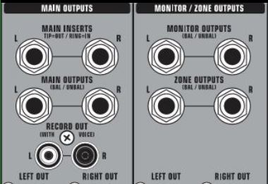

Re: Behringer DX2000USB Pro Mixer
Sure, I guess you can safely use the "RECORD OUT" RCA jacks OR the ZONE OUTPUTS - as I assume they all containe the same main output signal (just like the MAIN OUTPUTS - but I assume you'll use these already? - if not, you can also directly use the MAIN OUTPUTS).
I assume you'll connect your Speakers to the MONITOR OUTPUTs, as these should be 'dimmed/muted' automatically when yous MiC fader is on/up.
Let me know if all that solves your issue.

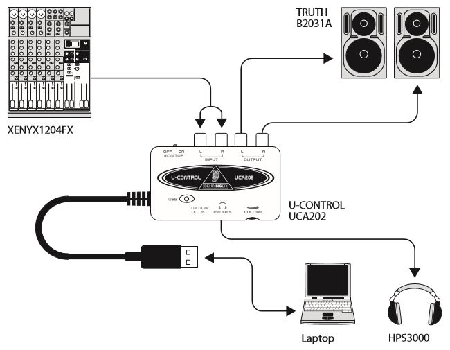

I agree with you, the Record Out is connected with L/R Input on audio interface. Exactly as you wrote, the speakers are connected on Monitor Outputs (on mixer), this means that I can ignore the audio interface L/R Output (?) to avoid affect the “dimmed/muted automatically. Do you think that my reasoning is correct?
They suggest the following application example (my idea, as I wrote before, is to leave blank the L/R Output:
- ucontrol.JPG (48.11 KiB) Viewed 10877 times
The older I get, the better I was.
Yes, your reasoning sounds correct!
Yes, leave the Output of your U-Control blank!
And your headphones should be connected to the Behringer mixer and not to the U-Control!
Guess you'll now have it
Why is the audio device not working? Is it broken?
However, what the 'expert' was saying, was exactly what I was asking initially ?!
Please do the following:
Only connect the Behring USB as a device to your PC and reb oot.
Now start PF and go to your mixer input channel and make a double-click on its name to invoke the "Input Device Configuration" dialog, just as shown in your screenshot 8 posts above.
In your "Input Device Configuration" dialog now open both:
a) the 'Device' combo box - and tell me exactly what devices are listed here!
b) the 'Input Source' combo box - and tell me exactly what names are listed here!
Then switch to the 'WASAPI' driver model and report the same.
Maybe you now 'see' your Behringer 'USB output which carries the whole desk output'.
Else ask the 'expert' what name should be listed/select to record the mixer output signal.
No, the audio device is not broken, but after trying different connections there is only one option to get output sound (internet sound) but in that case I lost sound on studio (headphone and speakers), that´s why I can use it.
Following your instructions after restart PC here is the result:
Driver model WDM
INP – Input Device Configuration (Mixer Channel)
Devices names listed on “Device combo box”:
- Microphone (USB Audio CODEC)
- Microphone (Realtek High Definition Audio)
Input Source name listed:
- Master Volume
Driver model WASAPI
- Realtek Digital Output (Realtek High Definition Audio) (SPDIF)
- Speakers (Realtek High Definition Audio) (SPEAKERS)
- Speakers (USB Audio CODEC) (SPEAKERS)
- Microphone (USB Audio CODEC) (MICROPHONE)
- Microphone (Realtek High Definition Audio) (MICROPHONE)
Input Source combo box name listed:
- SPDIF
Hope this helps.
- Master Volume
Driver model WASAPI
- SPDIF
Hope this helps.
