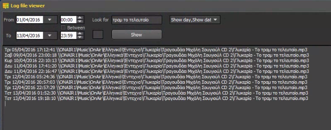

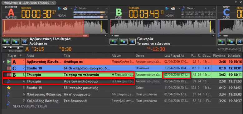

Bernd I am also trying to find what is wrong.
I test on Find Track window the script find expression.
It returns a number of tracks for example 115.
I add the column "Last Played At" and sort on it.
I see for example a song last played 05/04/2016.
But I check my log and I see the same song played 3 times yesterday !
Also looking at the debug log I 've found the following exception (maybe it's not related to this case):

Yes it's the same physical song from the same media lib.
I don't know how often you save the "ProppFrexx MediaLibraryServer.entrystats" to disk but it seems that not all the played items are updated into the file.

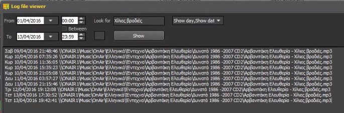

Look again:
Look the LastPlayedAt.
But my playback log show that this file played many times:
This is yesterday's debug log:
https://www.dropbox.com/s/cenuwyshoyzpj ... 2.log?dl=0
You can find the titles by looking at the screenshot times.
And today's log (until now).
https://www.dropbox.com/s/ul7j8bpdzpjjq ... 3.log?dl=0
Also search for "Γλυκερία" in debug log to see how many times this entry exist in it.

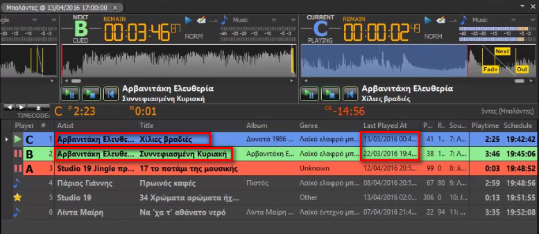

What really wonders me is, why you have 2 entries subsequently from exactly the same script-line!
This should never happen and can even programmatically not happen, and I never saw this happening! See your last screenshot!
Player C & B both seems to contain an entry derived from script-line number 7 ?!
How could this be? Are you sure no one manually adds tracks to the playlist?!
I might need to investigate your log file, so give me some time!
Because I have count of 2 in that script line.
