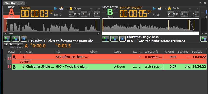

:lol: you took your time and you fixed it.
I tried before updating to v.30 and the result was this :
20141216 1.jpg (76.44 KiB) Viewed 9415 times

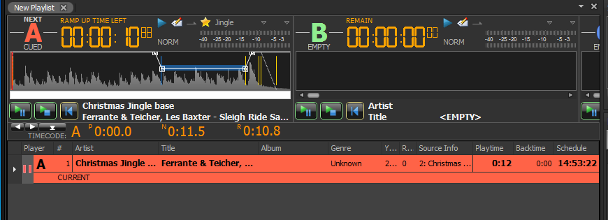

After updating to v.30 :
20141216 2.png (21.77 KiB) Viewed 9415 times
Although I got very stressed with this problem, I can only thank you for fixing it.
