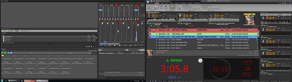

It happened again.OL should start at 18:30 but unfortunately did not. therefore, did not start playing playlist at 23:00. I don't know what. Really do not know what this could be. Whre can I look to discover a mistake? Until today it worked without problems.
Regards Jani
Regards Jani

I enclose a picture where you can see the OL window open but does not close.
- proppstop1.jpg (40.8 KiB) Viewed 12144 times
Re: Overlay stops
On the right side it brings OL window. In this case it is empty. The news at 18:15 were playing OK and this was playing the latest . Then OL did not played news at 20:15 and 21:15 and one more show at 18:30. Playlist played songs normal until the exchange of new playlists at 23:00 when PL stopped. probably because it is waiting for the OL to play but it crashed. I was running the latest version of ProppFrexx.
I really don't know what it what it's going on. Is it possible that at list playlist would start at given time independently from Overlay Sheduler that the Program Sheduler would play on?
Regards
Jani

In addition please activate the 'Debug Logging' in the general settings, section 'More Stuff' and send me the resp. Debug Log file when it happens again when using the latest v3.0.14.7...
Done this hope it will work now
