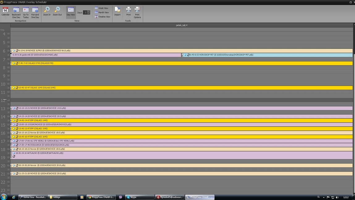

Unfortunately I can see almost nothing on that small picture - I can not even find any Overlay Player window on it.

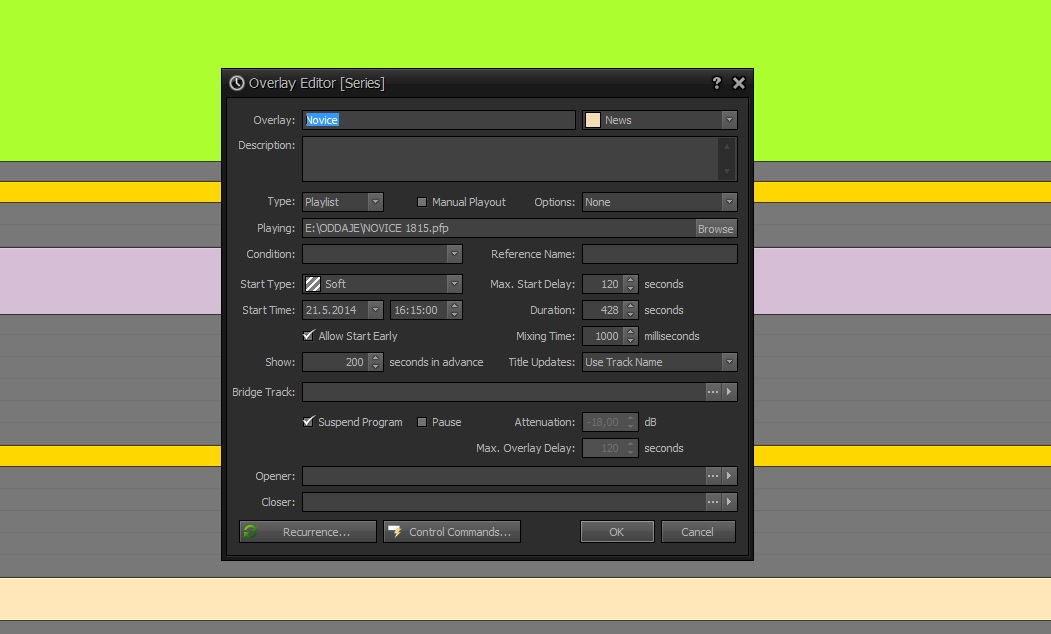

Possible the problem is that I copy a file in the overlay. I use a script that I have entered in the OL then just overwrite files. that is, until the day before yesterday worked great.
- OL setings.jpg (101.83 KiB) Viewed 13658 times

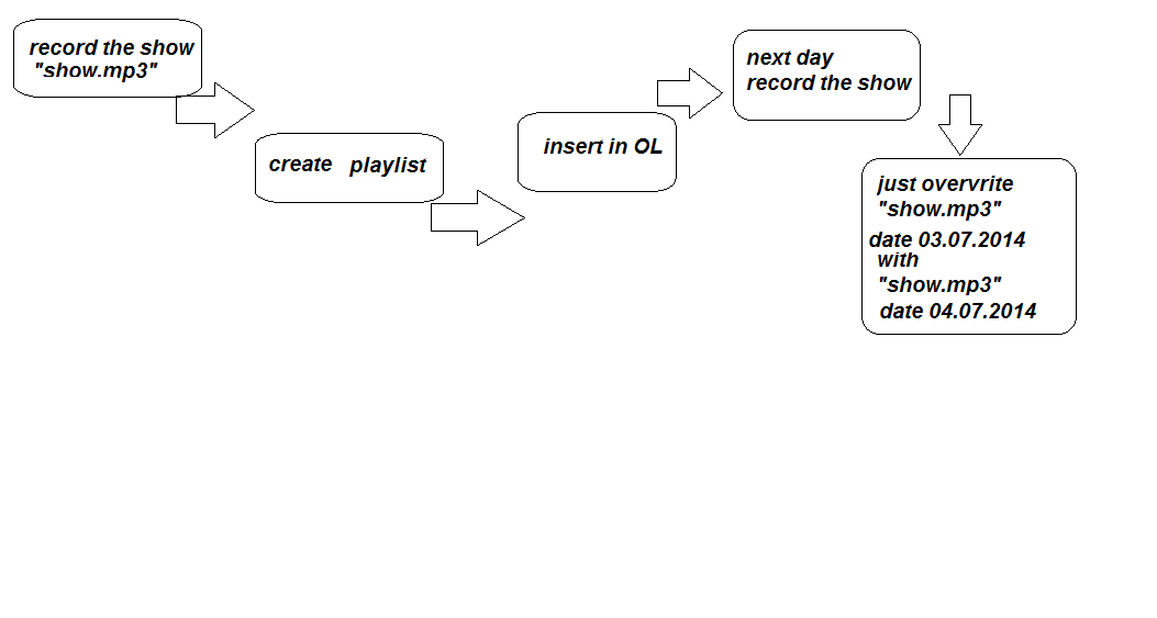

Yet Tues. The OL was normally broadcast at 12:15., Which means that the file is okay.

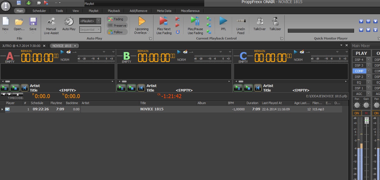

a) Who creates the 'NOVICE 1815.pfp' file?_ Sorry it is not a scrept but playlist. And the playlist was created ba me. I created the playlist and entered it in OL. Later on I just pewrite the files.
b) What files are referenced inside that playlist?_Only one file that is every day overwritten by the new one. I use 256kbps mp3.
c) Who creates the files being used inside the playlist (are they static or downloaded by some process)? _ I overwritte them daily.I record all the shows and repeat it later on.
If yes, what process is it exactly.
I hope I'm clear enough
- block.png (14.83 KiB) Viewed 13654 times
