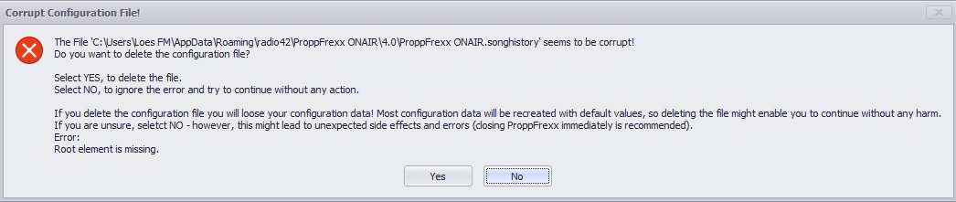

This is what i see.
EDIT:
30-10-2017 13:42:57 [v4.0.3.78]:********** Error/Exception Information **********
Error Message: Onvoldoende schijfruimte beschikbaar.
Error Type: System.IO.IOException
Error Source: mscorlib.Void WinIOError(Int32, System.String)
at System.IO.__Error.WinIOError(Int32 errorCode, String maybeFullPath)
at System.IO.FileStream.WriteCore(Byte[] buffer, Int32 offset, Int32 count)
at ProppFrexx.ProfileConfig.SetValue(String pSection, String pEntry, Object pValue)
at eF.f6.S3CD(Form , String )
at ProppFrexx.ScriptLibraryConfigDialog.OnClosing(CancelEventArgs e)
at System.Windows.Forms.Form.CheckCloseDialog(Boolean closingOnly)
********** End **********

radio42 wrote: 30 Oct 2017 14:00 Pretty much like the error message suggests: there is not enough space available.
This means: the file in the above dialog also got corrupted (in this case the song history).
You can check, if there is a .bak file for the given file available and restore that.
So I assume you are running out on disk space; please check your hard disk (on which you are saving your script libraries).

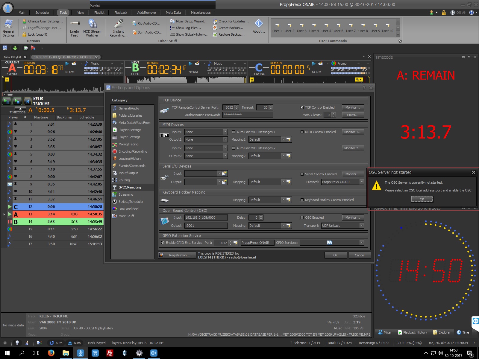

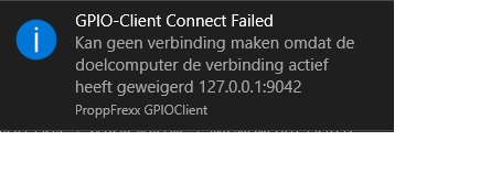

Now yhe GPIO, normally it opens, now it doesn't, How to tackle that?
EDIT:
Posts: 9155
Re: What is this?
Then please try to open it manually (ProppFrexx GPIOClient.exe), maybe it also fails because of corrupt config files.
If that is the case, you might need to delete all corrupt config files (due to your hard disk running out of space) and then probably delete all your config files.
Note, that all config files are store in your ProppFrexx AppDataUser folder.
So at best you restore a backup of these files...else delete all and start from scratch...

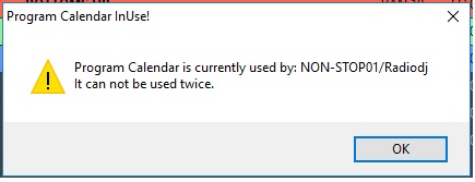

Posts: 9155
Re: What is this?
?? NO, I guess you are now running into tons of side effects caused by your 'out of disk space' issue !
Please try to hold down the CTRL and the ALT key (together) while pressing the Program Scheduler ribbon button.
This should release the 'InUse' lock file.
Else go to the folder where you have specified your program scheduler calendar file to reside and delete the related ".~lock" file manually.
