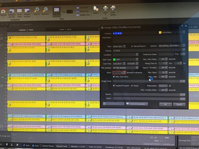

After latest Proppfrexx OnAir update overlay blocks don't loaded to playlist in OnAir. Here some pictures about situation. In overlay calendar very often is "Show second in advance" reset to "0" instead it must be "300" from the beginning (as it is on script). And impact is that any those overlay will not loaded and played in OnAir. BUG?

Now I have some pictures about this situation. Shortly; I have scheduler for announcements and advertisement example 18:45 https://www.dropbox.com/s/f4boni2b16gkv1l/1.PNG?dl=0

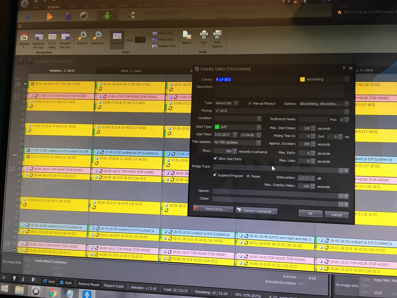

There it seems all right. Loading is set to 900sec before starting time. Problem is that randomly all schedul's will not loaded (both anounc. and ads.). After missing loading and starting/executing this on time in the scheduler "show second in advance" is "0"
https://www.dropbox.com/s/o0l2nbu43gz0lsb/2.PNG?dl=0

Posts: 9066
Re: Overlay load not happen
For your screenshots all looks fine!
You have scheduled an embedded Overlay Container to your playlist (see your movie link, currently loaded into Player A).
Whenever an embedded Overlay Container is used in a playlist, this means, that NO other Overlay is further automatically used from the Overlay Scheduler.
This is a global policy to prevent duplicate or mixed playouts.
I.e. either schedule and play ALL overlays through the Overlays Player OR resolve and play all overlays through the playlist.
You cannot mix both modes!
As explained above, once an overlays scheduler entry was triggered (no matter if played or missed) its 'Show in Advance' time is reset to 0.
All works as designed.
