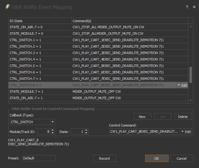

Here's on odd thing:
The D&R airlite has 16 buttons that can for instance start a Cart from the cardwall.
Now I have loaded 16 cards into CWI and use this events scripting as following:
OnCartPlay
EXEC_SEND_DRAIRLITE_REMOTEON 7|1
EXEC_SEND_DRAIRLITE_SETLEDBLINK ${cartid}|1|0|1
This works great for the first row on the airlite (1-8 row A). It plays the cart and acts exactly as I want.
But the second row on the airlite (1-8 B) won't start the respective carts. Weird thing is that when I manually start Cart 9 (by mouse) it does blink at the correct button. Just the button start doesn't work from carts 9 to 16 (1-8 B).
Am I missing out on some command or routing?

Re: On airlite second row fastbuttons won't start
The above are the commands you send when a cart starts playing.
I guess your issue is when you press the 2nd row of buttons on your console.
In order to know what might get wrong I would need to know your GPIO mapping for these buttons.
Theses are configured (as you might) know in the GPIO Client Application.
Can you post your mapping settings for these Airlite events.
In case you are using this mapping:
https://github.com/benhartwich/proppfre ... ee/Airlite
Please contact the author of these mappings (since it is not me how provided them).
But as far as I know the above mapping is only using the left row of the console buttons to trigger the cartwall carts. The right row is mapped to other commands.
I think you now allready answered my question
Look at the picture and you see 1-8 defined, I probably need to configure 9-16 aswell.
Done, and solved
