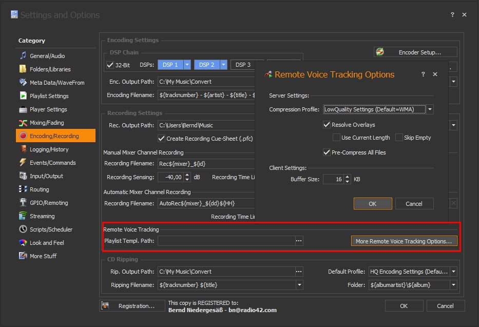

Server-Side: Configure the remote voice tracking encoding and compression settings

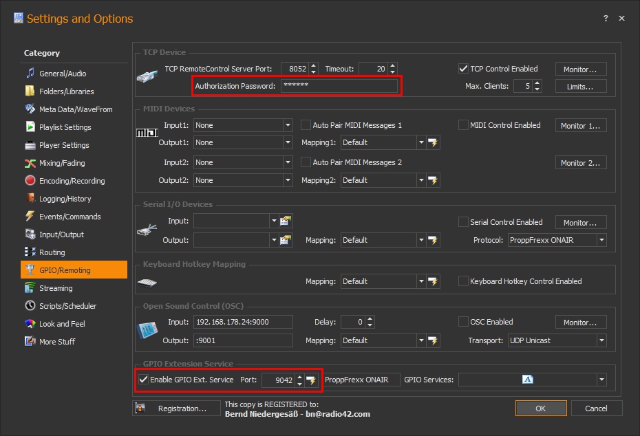

Server-Side: Configure the GPIO connection settings
Authorization Password: This is the password to use on the client side as well.
GPIO Ext. Service Port: This is port number to use on the client side as well.

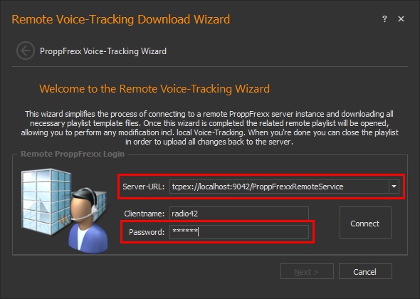

Client-Side: Connect Settings
Server-URL: Is composed out of the server IP or DNS name plus the GPIO Ext. Service Port as configured on the server side.
Password: Is the same as the Authorization Password as configured on the server side.

On the SERVER instance, make sure, that you ‘Enable GPIO Ext. Service’ – see general settings, section ‘GPIO/Remoting’.
Note the Port Number (default is 9042).
Also remember the ‘Authorization Password’ under the ‘TCP Device’ section.
In addition define a compression encoding profile in general settings, section ‘Encoding/Recording’ – now take a look at the new 'Remote Voice Tracking' group.
The Compression Profile always uses the specified default encoder of the related profile.
E.g. click above on ‘Define Encoder Profile…’ to define a new one! I am using WMA with just 48kbps as the default! As the WMA encode is pretty fast and good.

Here you just click on the NEW main ribbon tab arrow and select ‘Remote Voice-Tracking…’
This opens the ‘Remote Voice-Tracking Download Wizard’.
As the ‘Server-URL’ specify at least the DNS/IP address of the server instance as well as the GPIO Ext. port, e.g. “192.168.1.17:9042”.
The ‘Clientname’ can be ANY name – it’s just for info…
The ‘Password’ MUST match the servers (see above) TCP server password (see Authorization Password)!
Now click on connect…
