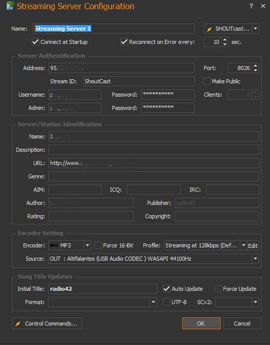

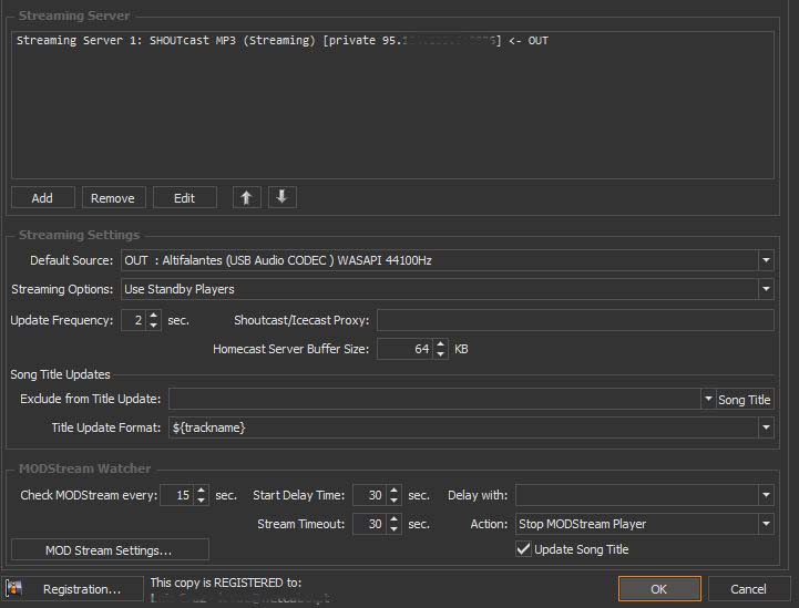

Hello,
Server is online, but there is no active source connection. My problem is that I don´t know how to configure it even after trying some changes.
Some help will be appreciated.
Thank you.
Luis
Thank you.
Luis
- server3.JPG (44.5 KiB) Viewed 7743 times
- server2.JPG (61.44 KiB) Viewed 7743 times
- server1.JPG (57.7 KiB) Viewed 7743 times

What Shoutcast server are you using a v1 or v2 ?
If it is a v1 server leave the 'Stream ID' empty.
Press the '?' Icon at the top right of the streaming config dialog to get more help.

So is the streaming server connecting to the server?
But no audio is being send?
If yes, is the OUT mixer channel the right one? I.e. are the peak level meter moving?
Or is the streaming server not connecting to your CentivaCast server? If not make a click on the streaming server icon to get the last error message from the server.
In addition you might check your Shoutcast servers log file to get an idea why the connection is refused.
Eg make sure your source username is correct.
By default this is 'source' - and in the above screenshot it looks like you are using a different value.
So you might try to also leave the source and admin username empty.
Re: No active source connection
Working. The problem was caused by the username. Following your suggestion I changed for "source" and it´s OK.
