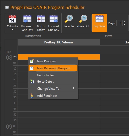

To automatically schedule your regular playlist files, the "Program Scheduler" is the right place to do so (see the 'Scheduler' ribbon tab and click on the 'Schedulers' button to open the 'Program Scheduler' - which works like an Outlook like calendar).
E.g. you can create a program scheduler entry (right-click and select 'New Recurring Program') and assign a dedicated 'Script' to it.

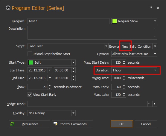

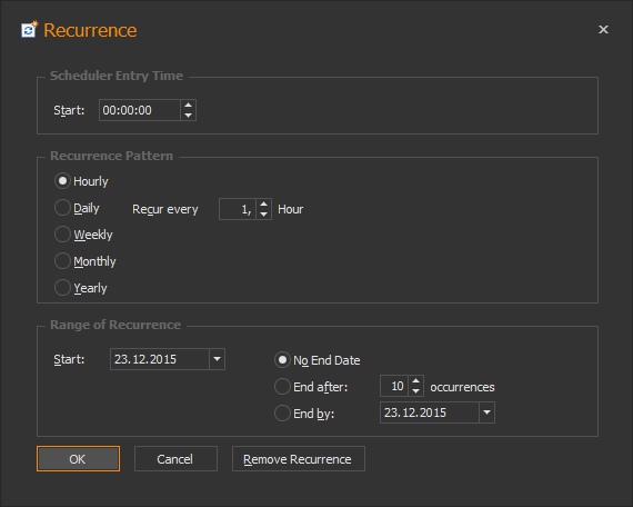

The Program Scheduler entry you need to create might be an hourly recurring one (select 'Hourly - Recur every 1 Hour') and you might then use a single common 'Script' containing at least one script-line to load those (pre)generated .m3u playlist files.
In the Program Editor you might simply click on the 'New' button next to the Script to create a new script on the fly - just give the script any meaningful name...

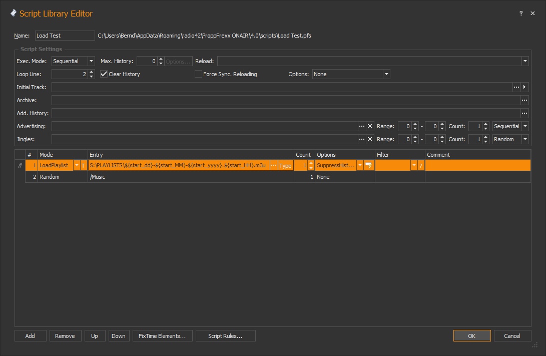

Then in the script editor, use the script-line action "LoadPlaylist" to load the playlist content (just as shown below).
Note that you can use any of the script-line macros (as listed in the user manual) to specify a dynamic playlist filename to load.
E.g. "S:\PLAYLISTS\${start_dd}-${start_MM}-${start_yyyy}.${start_HH}.m3u" will load a playlist file with the format 'dd-MM-yyyy.HH.m3u'. The year, month, day and hour will then be resolved to the related scheduler entry's start time!
As such you can assign this single script to your newly created program scheduler entry to load the dynamically generated playlist files.
As the program scheduler entry is hourly recurring, it would repeat every hour with a new start time, which is then used in the macros to resolve the playlist filename:
Program-StartTime -> Script's LoadPlaylist Filename
19.02.2016 19:00:00 -> "19-02-2016.19.m3u"
19.02.2016 20:00:00 -> "19-02-2016.20.m3u"
19.02.2016 21:00:00 -> "19-02-2016.21.m3u"
19.02.2016 22:00:00 -> "19-02-2016.22.m3u"
19.02.2016 23:00:00 -> "19-02-2016.23.m3u"
20.02.2016 00:00:00 -> "20-02-2016.00.m3u"
20.02.2016 01:00:00 -> "20-02-2016.01.m3u"
One more comment regarding the script. You might notice, that I set the 'LoopLine' parameter of the script to 2 and also added a second script-line to randomly pick a track from a media library called 'Music'. This is just in case your playlist is short in time and addition tracks are need to be scheduled to fill the gap. This also prevents, that in such case the playlist is not loaded twice. The background is, that if more tracks are needed, any script would simply loop to get more tracks, so without the second script-line the LoadPlaylist script-line would be looped...to prevent that, the second script-line comes in handy and that is also the reason, why the LoopLine parameter needs to be set to.
