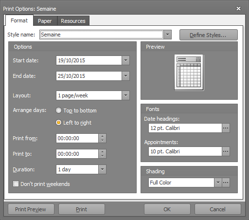

Good News (after a chat with the UI vendor), I guess I found a way to save and restore the 'format' options of the changed Print Styles and also a way to remove the 'calendar header'.
So it will be included in a next release.
Re: Print Options
The v4.0.0.21 is available - which includes the automatic save/restore of the Print Styles.

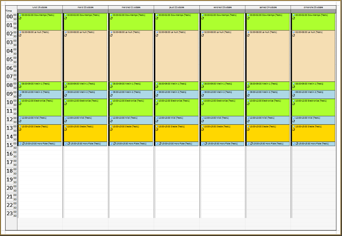

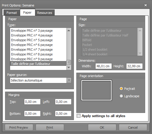

A thing to know : the paper size option is related to the default printer installed on the system.
To get the 30 min accuracy, I've set a custom paper size (48x33 cm) then save as PDF. If I want to print it on a A4 page, I simply downscale it on the PDF reader.
