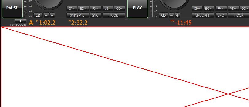

Had this error thrown just now ... thankfully ProppFrexx is continuing to play ... keeping my fingers crossed that the next program takes over ok at top of the hour
after the error the following happened to the playlist window:
can this be fixed without taking ProppFrexx of air?

Re: V4.0 error ... playlist window disappeared
It is already fixed. Please use the "Check for Update or Beta-Versions..." at the top right under the blue question mark icon. The version is either v4.0.0.5 or v4.0.0.6-beta
The bug was actually related to an issue in the UI lib I am using and how the docking panels are arranged.
Where is your TimeCode Window be placed?
Was that docked directly above or below the playlist window?

Post by inl_inc »
time code was below the players and right above the playlist ...
got the update ... thanks for always being on top of any issues
