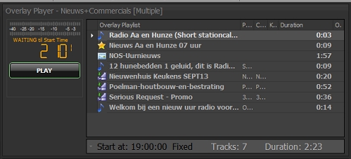

If I have 3 overlays in parallel that would be the problem. Cause I only see 2 overlays: fixed hour: news and after news the overlay commercials.
At 19.00 the news overlay starts with 2 jingles, than news (NOS-Uurnieuws). At the same time the news starts the commercials plays (5 tracks) at the same time!!

- overlay_news_and_commercials.jpg (71.08 KiB) Viewed 7839 times

What does start in parallel?
I can clearly see all 8 tracks in your Overlay Player - as such the overlay player itself can not start in parallel!
If there is something playing in parallel, this can only be because a track might contain a NEXT cue-point (may be at the wrong position - or a track contains a track insert transition)!

The News overlay contains: Radio Aa en Hunze (short stationcall), Nieuws Aa en Hunze (announcement) and news (downloaded every hour)
The Commercials overlay contains: 12 hunebedden 1 geluid, Nieuwenhuis, Poelman, Serious Request and Welkom.
The news is playing parallel with the commercials...
So when the news start, the commercials start too.
As I said before: before version yesterday we didn't had this error. Nothing changed, only update to latest version.

After looking at the settings, it turned out, that the ACPD for the 'News' media entry type has never been set and that therefore the News got ACDP calculated and that it was simply the NEXT cue-point causing the behavior - so all worked as designed!

We just did a TeamViewer session...the outcome was as expected:
The script they used contained for the NEWS track (resp. the related script-line) a "Track Insert Transition" - as such the sub-sequent Jingle and the News track where playing in parallel - just as defined in the Transition. so the overlay worked as expected and correctly.
We removed the transition - and all worked fine again
Funny enough, that no one remembered to have defined that transition...
