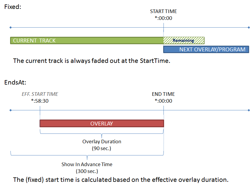

The standard/default Fixed and EndsAt behavior hasn't changed
StartType FixedEndsAt.png (19.47 KiB) Viewed 14683 times

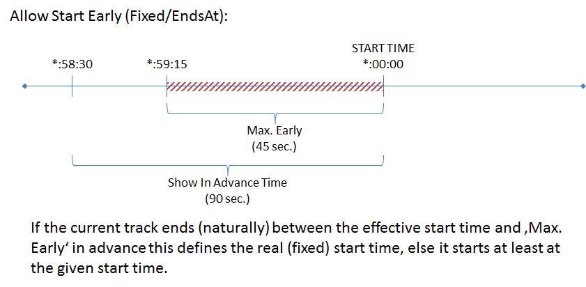

The "Allow Start Early" option is unchanged. An overlay is "Show In Advance" seconds shown early, but the "Max. Early" value defines the real point in time when the overlay might be started early (if a currently playing track ends in that range).
StartType AllowStartEarly.png (10.97 KiB) Viewed 14683 times

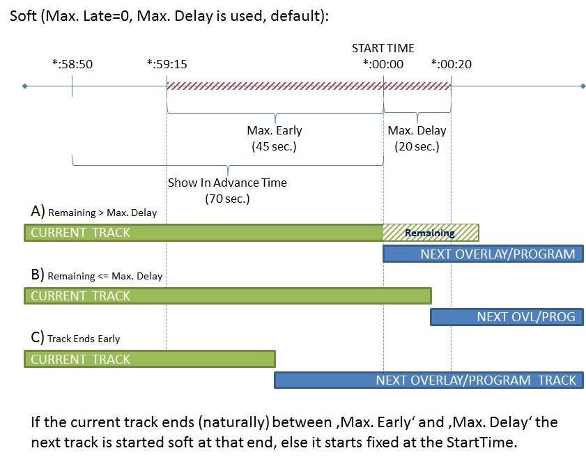

When &quot;Max. Late&quot; is set to 0 the standard/default behavior is used!<br />The remaining time of the current track of the current playlist defines, if that current track plays til the end or if its faded-out exactly at the &quot;Start Time&quot;.
When "Max. Late" is set to 0 the standard/default behavior is used!
The remaining time of the current track of the current playlist defines, if that current track plays til the end or if its faded-out exactly at the "Start Time".
StartType Soft1.png (19.75 KiB) Viewed 14683 times

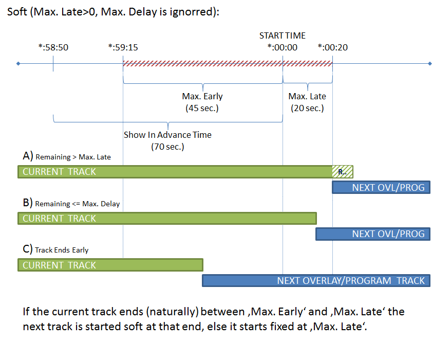

When &quot;Max. Late&quot; is set the new behavior is used (&quot;Max. Delay&quot; is ignorred)!<br />If the current track of the current playlist would end too late, it doesn't start at the &quot;Start Time&quot;, but &quot;Max. Late&quot; seconds after.<br />The currently playing track is at least played &quot;Max. Early&quot; + &quot;Max. Late&quot; seconds!
When "Max. Late" is set the new behavior is used ("Max. Delay" is ignorred)!
If the current track of the current playlist would end too late, it doesn't start at the "Start Time", but "Max. Late" seconds after.
The currently playing track is at least played "Max. Early" + "Max. Late" seconds!
StartType Soft2.png (18.95 KiB) Viewed 14683 times

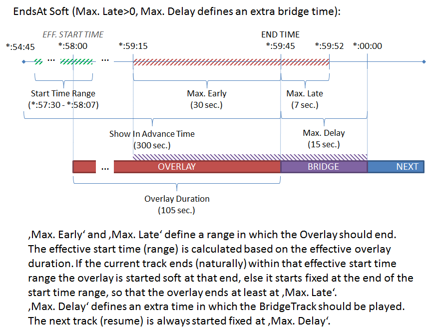

When &quot;Max. Late&quot; is set with the EndsAt&quot; start type this allows you end soft (and &quot;Max. Delay&quot; got a new meaning)!<br />As the effective start time is calculated based on the overlay duration an effective start time range is used.<br />&quot;Max. Delay&quot; now gives some extra time and therefore finally defines a fixed End-Time! But as the overlay might end earlier, the BridgeTrack would be used to fill that gap!
When "Max. Late" is set with the EndsAt" start type this allows you end soft (and "Max. Delay" got a new meaning)!
"Max. Delay" now gives some extra time and therefore finally defines a fixed End-Time! But as the overlay might end earlier, the BridgeTrack would be used to fill that gap!
StartType EndsAtSoft.png (39.69 KiB) Viewed 14535 times
