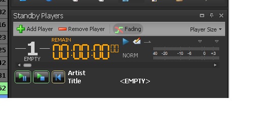

Bern
Maybe i'm not looking well, but i can't find it. See the att screenshot
Oeps i got it working on a test system, but on my onair it doesn't do anything when pressing the errow
Do i have to set de stanby player in a special mode

Re: Stack mode
The Player Size needs to be at least "Medium" in order to be able to toggle it to the stack mode.
Else these is no space for the stack playlist.
Once the size is changed to "Medium" click on the 'arrow' icon (which is the right most of the three icons in the middle; next to the 'pfl' and 'tag' icon).
Once toggled the 'stack' icon is displayed...
