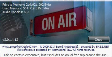

Just a question; is it normal that when memory increase the audio-handles increase too?
Maybe strange question: what are those many audio-handles doing?
- audio-handles_growing.jpg (100.84 KiB) Viewed 6385 times

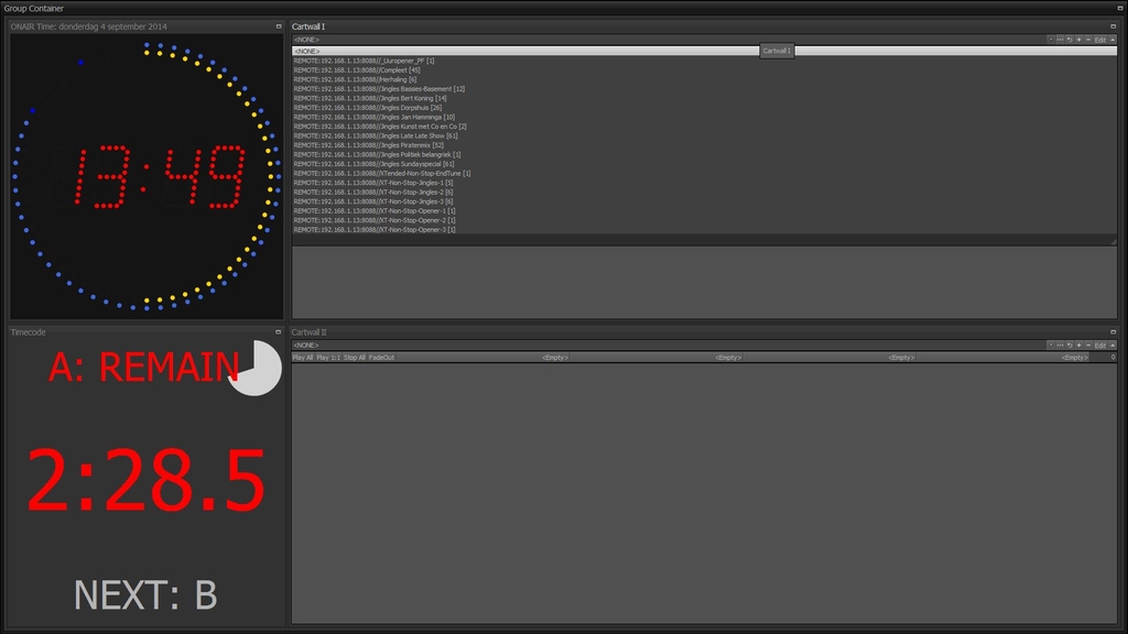

Number of standard carts used in our daily Muziekmix (auto-deejay) is 30 (random choice).
The view of cartwall I and II is empty now. Only when doing a dj show the person can pick his own carts: zie picture with cartwall 1 and 2

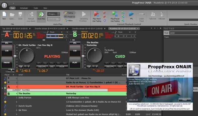

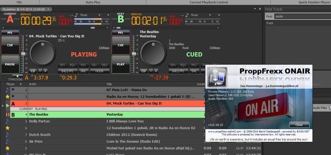

I also did a little test: 1st picture you see some open playlists. 2nd picture I closed them; only at that moment memory and audiohandles decrease.
So there will be a moment every week; the memory and audiohandles are too high, which ends the application.

- audio-handles_1330.jpg (147.37 KiB) Viewed 6378 times
- audio-handles_1332_afterclosingplaylists.jpg (127.22 KiB) Viewed 6378 times
- audio-handles_nocarts.jpg (113.28 KiB) Viewed 6378 times
