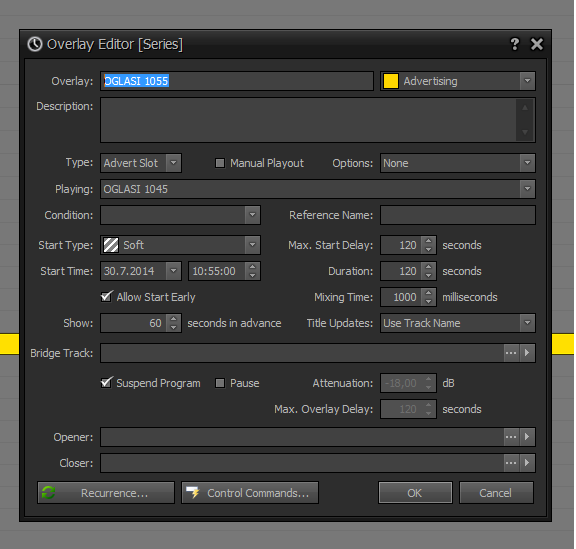

I don't know what I'm doing wrong? A lot of times it terminate the song that start and it doesn't wait until the end of the song. I have the soft set. What do I have to do that OL will wait until the end of the song?

Thank cue points are not as they should be.

a) make sure to use the latest ProppFrexx version (v3.0.14.9)
b) make sure your tracks do have correct cue-points set, e.g. the Cue-Out and Next cue points are correctly set
Else than that it should never happen - and in my tests here it also does not happen.
But what are your other settings/setup, e.g.:
- is a program/playlist changing as well while the overlay plays?
- are any other Overlays scheduled in parallel or right before/after?
