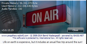

An hour ago PF crashed again. At the time of the crash I check memory and it was 530 MB.
After rebooting system I upgraded to the latest version. Also I changed some settings you told me.
The unofficial update I didn't install yet (just saw your latest thread); also I didn't disable Superfetch yet.
But... clicking on the "!" reduces a lot memory! I didn't notice that tiny little "!" before, so please make it bigger!!
I will let you know these days about the memory issue.
If you didn't plan any destination for holiday yet; here in Annen (NL) near the studio is beautiful landscape
- Private_Memory.jpg (47.25 KiB) Viewed 13384 times

Re: An exception was thrown by a TaskScheduler
It's not always possible to upgrade directly (due to live dj-shows) to the latest version; now it is.
Clicking on the tiny "!" is doing a great job.
This afternoon I'm going to install the unofficial update. I'll let you know.

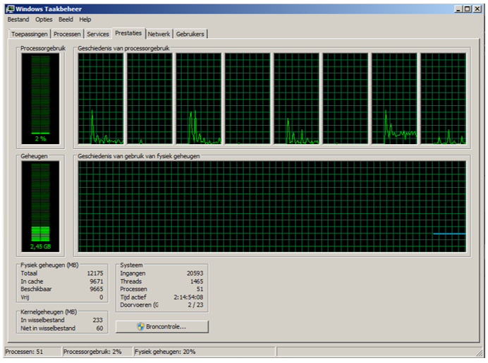

As the other user having a similar problem just reported, that his free remaining memory was only 100 MB it could be the same in your case.
Can you please check how much free memory your task manager reports and if there is any other process eating up your memory?!
Thanks, XTended is on holiday so I didn't hear that. This morning before the news of 08.00 again complete PF freeze. Memory usage only PF 400mb and MLS also 400mb, see the screenshot. Total memory load of 2,4gb. After that i updated PF to version .26 I hope that will fix it.
That's funny, "Beschikbaar" and "Vrij" mean exact the same ... I will monitor it. Thnx!
Please take a look to the list of processes and click on the for all users button to see really all processes. And scan which processes take all the memory.
